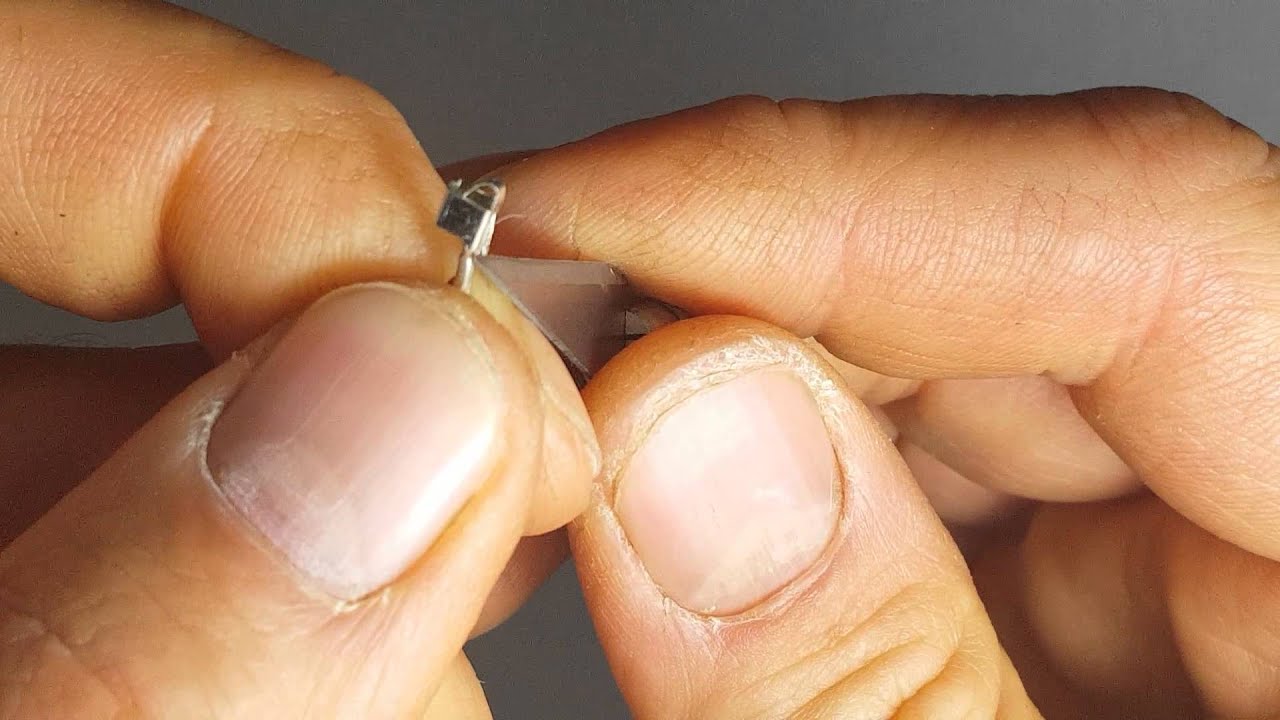

So should I try reversing the motor wires? And if so, any hints on how to pop the wires out?
There is a special tool to do it, but it is possible to do it with a really small screwdriver or a wire, maybe a phone sim card tool. Each pin has a part that bends up to hold it in place, you just press that part to release the pin from the white connector housing and slide it out. Do that for both pins, trade them places and press them back in. If you bend them too far, they won’t stick back in very well, so be gentle with it. Maybe like this video shows:
I don’t think you need to take the wires out. The labels for M+ and M- are arbitrary since a DC motor + and - swap when the motor changes direction.
