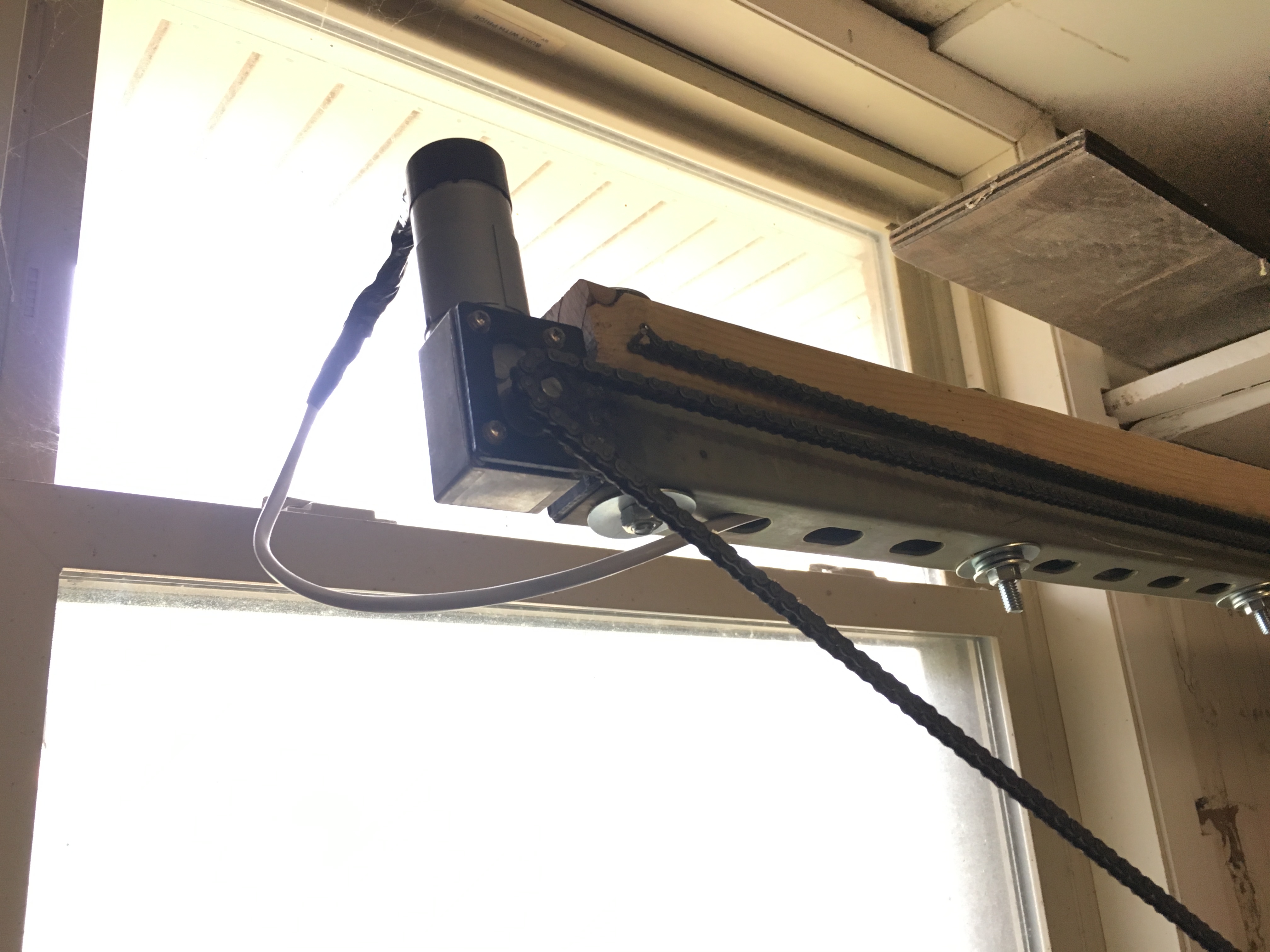

Due to insufficient support of the top bar I had a very small amount of flexing and quite a bit of twisting of the strut. I bolted a 2x4 to the top of the strut every few inches and that took away the twisting. During the “pull chain tight” part of calibration, I could see the left side of the top bar pull out, in the z direction, about 4 mm. I’m not sure how big of a deal that is since the “pull chain tight” action is a lot more force that normal operation (right?)…thoughts?
The stock motor brackets are welded to the end of the strut instead of the top. The thought is, the bracket on the end would be less susceptible to weld movement (weld cracking or fasteners loosening, if going that route) …thinking the forces on the weld would be slightly less. I meant to have them pointing down to reduce overall footprint, and aesthetics. After trying to solder the motor connector pins to the cable wires, I gave up and bought some pre-made pig tails and then soldered those to the cable. Not pretty but saved a lot of time and frustration for me. I could dig up some amazon links if anyone is interested.

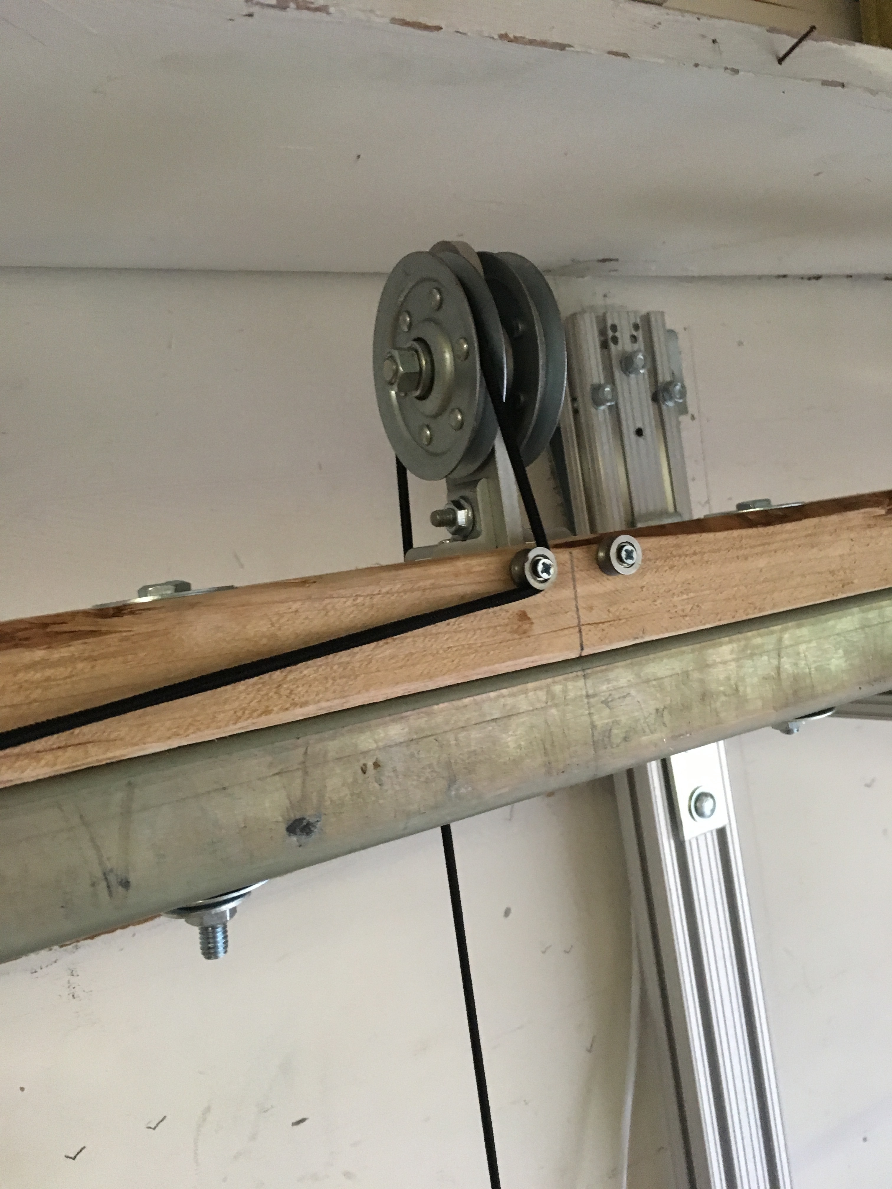

I also found this pulley at work and used it for my chain slack tension. 2 lb. concrete bricks from Home Depot seem to be working well at providing a consistent amount of force on the slack. I have moved the sled in all corners of the 4x8 and the bricks move up and down only a few feet. I moved the left side brick off to the side to prevent them from getting tangled. A downside to putting the bricks in the middle is that it can get in the way of whatever you may plan on storing back there.

One of my objectives was to have a collapsible frame and not cover the window or obstruct my other tool bench area toward the front of the garage. In order to stick with all that, I got a little crazy and bought a 12’ steel “s” beam from Metal Supermarket for $109. The beam is pretty rigid and does not flex with my weight on it, however, the next weakest links in my “unique” design continue to present themselves…
I drilled holes through the top and bottom of the beam to use the same mounting technique from before. This cobalt bit from HomeDepot made quick work of it and I highly recommend it!
I mounted the beam with the same hardware as before, so its position can be adjusted.
Pulling down on the unsupported beam at left results in a transfer of force to the bracket and the long 80/20 rail; both flexed. I added supports here to transfer the force back to the wall.
Now, pulling on the unsupported left side of the steel beam, the very top of the strap hinge is flexing away from the wall (these are the only anchor points). I may try to run another bold, closer to the hinge pin, into the stud but in reality the remaining flexing is not much.

2- Be carreful to protect your wiring from accidental chaffing along the sharp metal edges. You could use tie raps to hold things down and prevent rubbing movement than may wear out the electrical insulation.

5- To hold the sled weight with best rigidity at the top beam, the closest the top beam support ar to the motors, the best. Here, I would say you are going to observe too much flex. Shifting to the left until you can use the left window frame /closest wall stud is one way to go. Keeping the window clear is quite a challenging objective!
