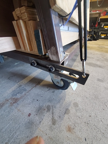

I used my time over quarantine to design a frame that can be disassembled and stored away if needed while maintaining adjustability. Like many others it’s also used as a lumber storage rack behind the waste board. MUCH MUCH sturdier than the wood frame you can make to get you started with the kit (though that frame WILL let you cut the same day you buy the wood and the results are not terrible)
Top bar is adjustable as well as bottom brackets for tensioning

that’s because the guide wheels are inside and too close together. if you spread them to the outside like this plate it will be much more stable. if your c beam is 40x80mm then this plate should work;

I found that out last week and already have one in the garage ready to swap but my mistake was not ordering from a site that includes the rollers and cam bolts.
