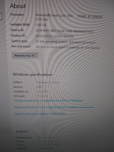

Right Click on the Window launch icon, click on system, then choose About. THis will show CPU, RAM, memory what build of Win10.

I saw no “about” in that menu.
I searched "about and found this:

Your laptop is probably around 10 years old. Intel stopped producing drivers for it, thus no Windows 10 driver.

Yeah, I would get into contact with the sellers of that computer, with a cpu that old, it’s just a matter of time until it tries to update the driver and breaks something. That chipset was only supported up to windows 7, the driver you are using is a windows vista driver that just happens to barely work in windows 10.
@Jamtek it is a desktop PC if that matters.

ah, if it’s a desktop, then yes, a graphics card will fix the problem
