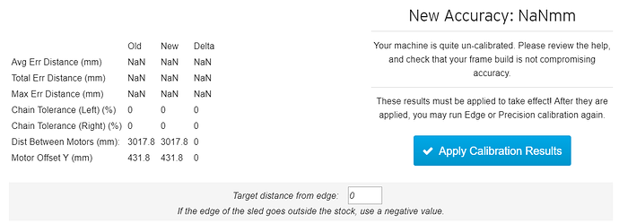

Well, this is not promising:
I don’t understand. Totally unexpected. I thought it would have been pretty close. Most of my edge distances were only like 0.020" off the target. I had one that was 0.25" on the bottom left.
Thats better (I changed nothing):
