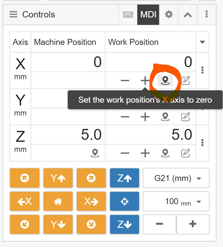

  • machine vs workspace commands
  • zero machine z
  • zero workspace z
  • Zero workspace X
  • Zero workspace Y
  • how to fix soft limits → 1. disable by setting to 0 or enable by setting to 1, then 2. click the save icon
  • Moving cutting location on the workspace (for the cut only. will not affect calibration):
  1. move sled to desired workspace home position (indicated by the dot)
  2. zero the x and the Y axis (supposed to be at 100, so (-1) - 99 = -100, so it was 100 off) :
