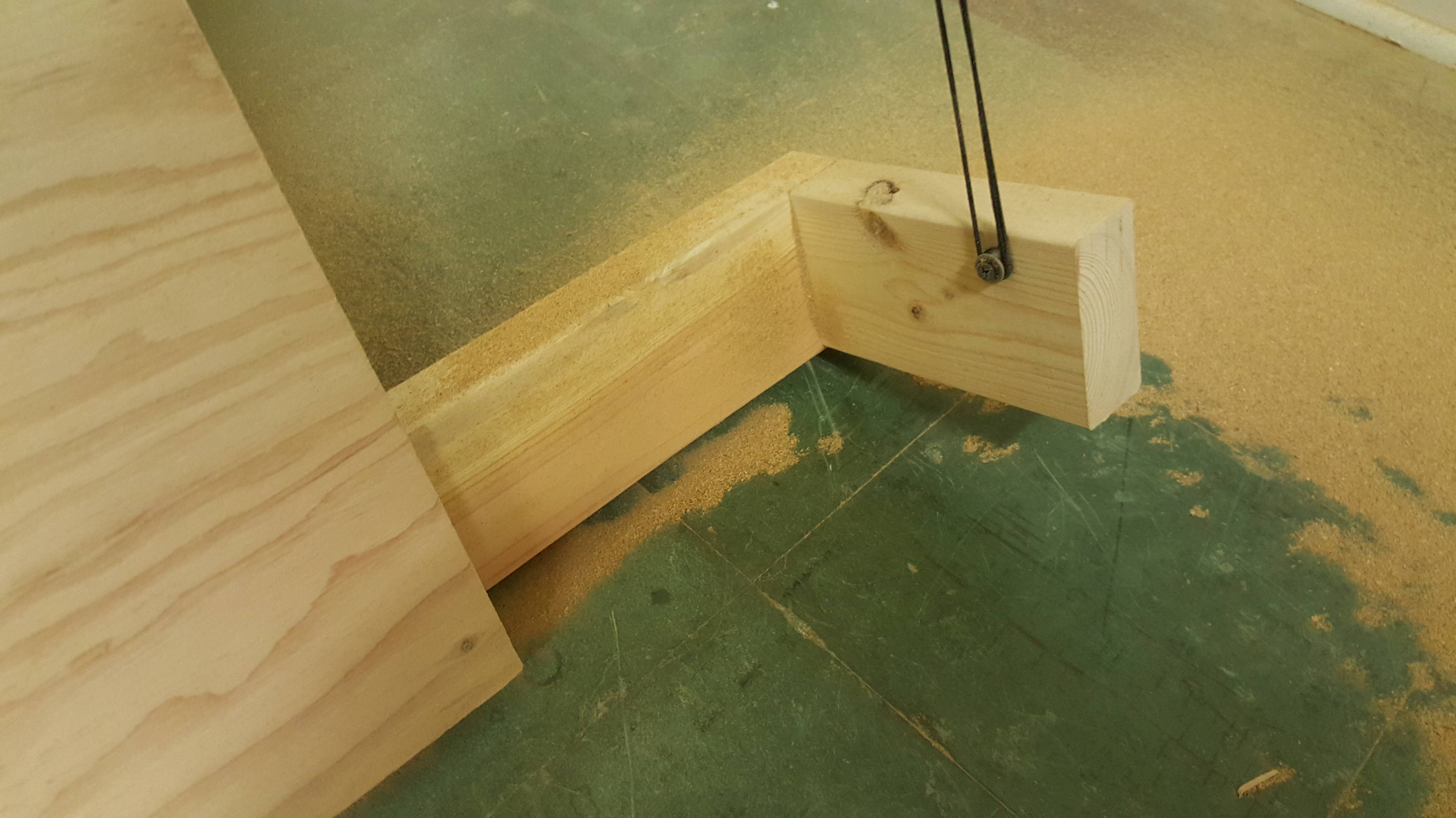

When I cut out my frame pieces, I was left with two pieces of 2X4 about 6" long.
I attached those at 90 degrees onto the bottom frame pieces (where the brass hook and pulley are) so they stuck out like feet on each side. I then moved the bottom brass hook out (and in front) of the work piece so it was directly in line with the sprocket above it. Ended up being 4 3/8" in front of the face of the rear frame arm.
The sprocket chain travels smoother now.
Could you share some pictures?
As you can see, I am cutting without issue. Aligning the chain inline with the socket seems to have helped.
That is excellent advice! I’m planning to do a total frame redesign pretty soon and this seems like a great feature to include. How did you join the 2x4s and would you recommend doing it that way? Is there a way we could use a CNC cut piece of plywood there that would be easier?
I joined the 2X4’s using the supplied long black screws (2 per side). As the stress is really minimal, I’m sure adding it to the 3/4" plywood SVG’s would be no problem.
As this is just my temp frame, I will probably incorporate into my final frame was well.
Oh, and Bar…I suggest replacing the bottom brass hook with one of the small black screws as well (as I did). The brass hook works it’s way loose pretty fast.
Already included in the next batch :grinning: I couldn’t agree more.
