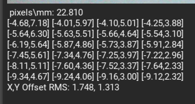

OK I think I’m at the point where I’m replicating what you’re doing.
  1. Open ‘Optical Calibration’
  2. Click ‘11 x 17 (Portrait)’
  3. Click ‘Calibrate’
  4. Click ‘Auto Home’ (wait for calibration to happen)
  5. Note the calibration results (mine are below)
39%20PM
  1. Click ‘Save and Send’ (and wait for logs to finish spitting out from the python stdout)
  2. Click ‘Auto Home’ again (wait for calibration to happen)
  3. Note the improved results
14%20PM
My error was pretty bad even after calibration, but looking at the values it seemed like my whole test pattern seems to be rotated clockwise around the zero position (note that I mounted my pattern differently so the position with [.02, .01] error is my home position). Sure enough after pulling out a bubble level, I verified that my test pattern is slightly clockwise. Any thoughts on how hard it would be to correct for rotation also? My top beam not being perfectly level is something I stress about :slight_smile:

Theoretically, this process will compensate for it. But, the code you are using has a setting for top-beam tilt in Settings->Advanced. It’s based on a positive angle lowering the left motor and raising the right motor. I got a clinometer app for my phone and it seems pretty sensitive. It also moves the right and left motors in/out based upon the angle (since distance between motors is fixed).

Theoretically, this process will compensate for [beam out-of-level].
Are you saying the current routine should compensate for it, or that it would be theoretically possible in the future? I was never able to get my error down, especially for the points furthest from the home point.
