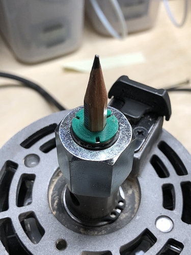

I chucked a pencil into my router with a little 3d printed part I made and dropped the z down until it hit the paper and It was within 1-2mm from center of the square (though a little bit below – likely because of the added weight of the router).
I was curious about what sort of results my pencil test would have yielded last night, so I ran the calibration again without using my optical center calculation. The results at the home position were significantly worse! My second pencil mark wasn’t even inside the square. This was not surprising, since my optical center is pretty off center in the frame. It’s likely due to my janky off-centered endoscope.
I think this has promise. Maybe I’ll try to 3d model a router attachment tomorrow and see if I can get the calibration to land right in the center of the square. Time to go to bed for now though :slight_smile:
Edit: Here’s the pencil collet model if anyone else wants to use it!
