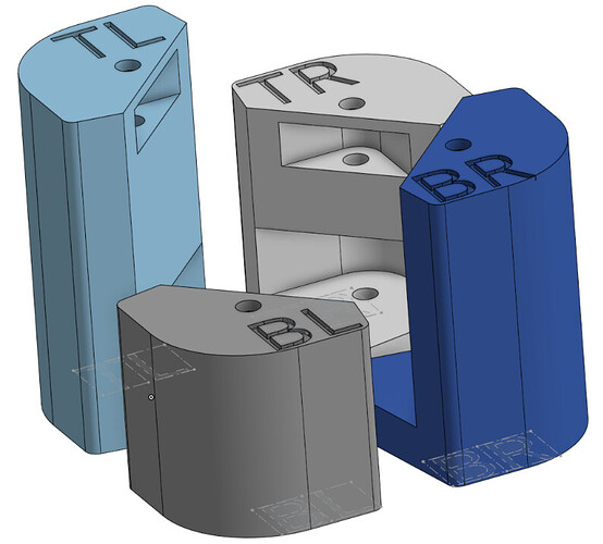

I created a design for a set of bolt-down anchors that raise the belt to the appropriate height to have them level
I did not have a maslow handy while I did this, so I don’t know if the height to the bottom of the lowest arm is reasonable (I put in 30mm, this will vary based on your workpiece and wasteboard heights)
it is parameterized so you can adjust just about everything, specifically including the base thickness and height to the bottom arm.
It is designed that you put a stud in the anchor and then put a nut in the bottom slot.
I have not had a chance to print this yet, I would love to have some people print it and suggest changes to the default dimensions.
If you have ground that isn’t level, there are parameters to add extra to each of the 4 towers to adjust.
@bar some version of this belongs in the not shop (once we figured out a reasonable default)

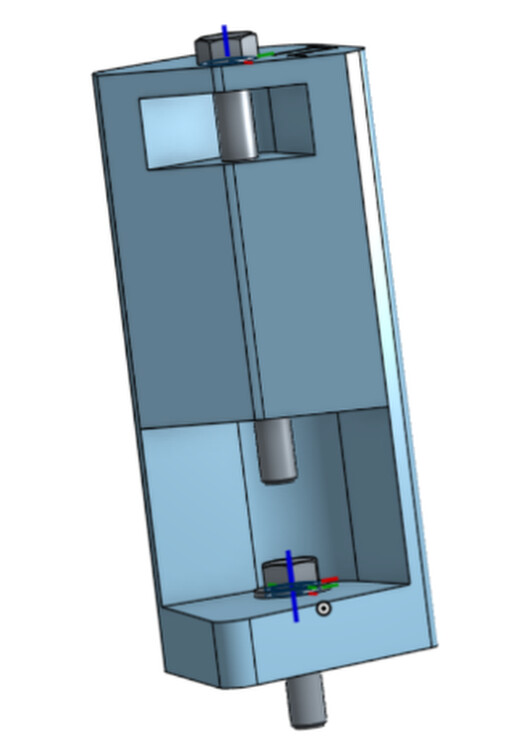

I’m not sure if I understand the mounting. Stud goes in the bottom section of the mount. Is there room for the nut? Or is the bolt supposed to go through it all and hold the cable as well? If not, what holds it cables?
the height of the bottom opening will depend on your wasteboard and workpiece thickness (height to the bottom arm - thickness of the bottom - 5mm) but there should always be room for a nut to go in there. If you have thicker material, there will be room for a bolt to fit in there.
to hold the anchors in place, get some 10mm/3.8 bolts 4 or 4.5 inches tall (ideally cutting off the threads so the anchors ride on the smooth part of the bolt) and they will just drop in place
something like this (this has the height to the bottom arm at 70mm with an 18mm base, which is about right for a 3/4 spoilboard and 3/4 workpiece) this is a 4.5” bolt on top (no nut needed)
and here is the minimum (12mm base, 4” bolt on top and stud from the bottom)

I cleaned up the model and set the default sizes a bit more sanely (including assuming 3/4” allowance for workpiece/spoilboard)
I also added a feature that if you give it your layer height it will try to use bridging to be able to print without support.
If I were to do a version of this in aluminum, I would not carve it out of a solid block, I would get a good size angle (say 3” or so) and cut three plates that fit inside the angle and have a hole in the same place, then weld them inside the angle, one at the bottom, the other two at varying heights spaced appropriately for each anchor
and a new version that doesn’t waste plastic printing above the notch
Question about this. should I leave the space below the notch solid (adds strength) or rely on the back and save the plastic?
I’d go with extending the wall out, but maybe making that area lower infill via designed voids and print at 100% infill, based on what I’ve learned over the last year. Can’t trust various printer/slicers to do infill consistently, or for people to all choose good infill and wall thicknesses. Would also reduce chances for retraction issues at vertical edges from seam alignment if none of them came to sharp corners, especially under overhangs at the top of those slots.

I’m still struggling with the top right one snapping (not either of the two taller ones, but the top right has snapped several times on me)
Ok, tweaking the parameters to be a bit larger/thicker, here is a good set
(120mm long wedge, 4mm shell)
I print in PETG rather than PLA as I’m in Phoenix AZ and PLA just doesn’t survive outside of air conditioning here in the summer
print these solid, I do it with lots of perimeters, but 100% infill should work. There are ribs and voids built in to the model.
These are setup for 75mm from the ground to the lowest arm (configurable in onshape) so if you are using thin wasteboards, you may have to put a couple layers on top of each other to keep the anchor from pulling up on the arm during calibration (when cutting, your bit will mean the router is higher)
Even though these are setup to step up each anchor, if your ground isn’t level, your Z offset to each arm will be different. But with the belts almost level, any error will have less effect than with the Z offset being larger.
