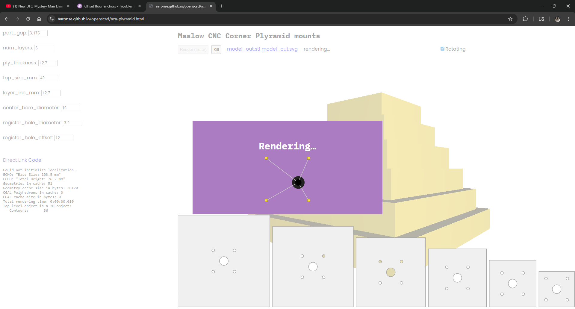

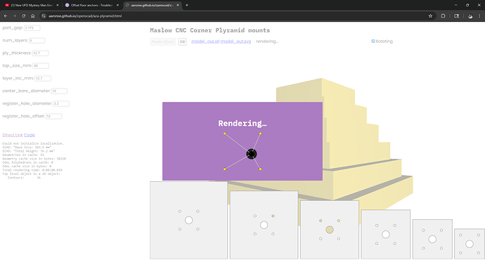

This is rough and quickly thrown together, but, thoughts on something like a web configurable Plyramid ™ corner mounts :slight_smile:
https://aaronse.github.io/openscad/aza-plyramid.html … (:warning: Takes a while to load since the page uses OpenScad compiled to WASM ~7.5mb).
Configure whatever num_layers and ply_thickness makes sense for the overall desired height, and material thickness you’re working with…
Ideally, the page would let you render and download .dxf containing each layer, bonus points for automatically tiling shapes ready to CNC. GCode generation would be great too, but, one step at a time…

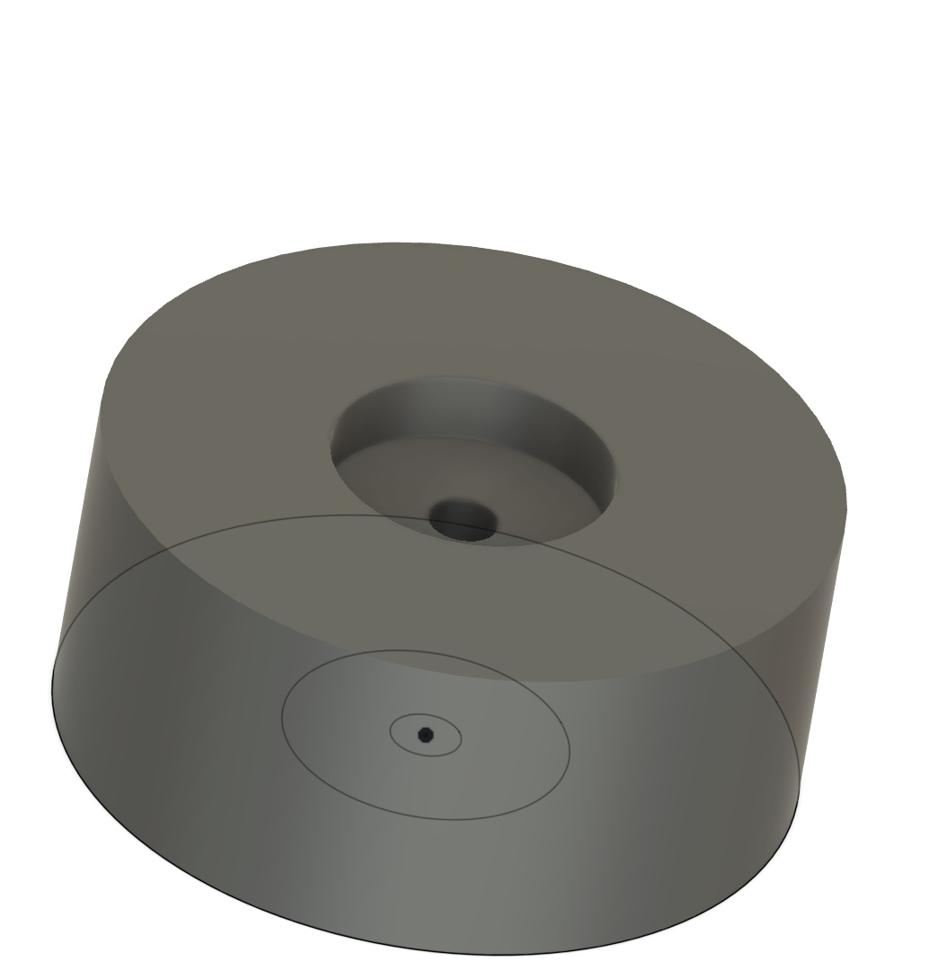

To minimize slop/pivoting on my uneven sloped garage slab, would likely supplement the Plyramids with wood shims, 3D-printed and/or wedge tiling shims.
What about this one? It is about 4 inches in diameter and 1.75 inches tall. You would start with the treaded rod in the anchor. Next would come the riser, followed by a fender washer then a nut. You would tighten this down to establish a firm base. I would then add another fender washer or two followed by the corner anchor and then another nut.
This would allow you have a firm elevated base but at the same time allow some movement of the corner anchor. I can post to Thingiverse if anyone is interested.
Updated https://aaronse.github.io/openscad/aza-plyramid.html , cleaned up and made downloading SVG or DXF templates easier. Tested that generated files can be used in EstlCam to create tabbed parts. Let me know if you want details on how to do this.
Page is slow to load and render on mobile (tested on Android), so added frivolous animated Maslow 4 themed progress spinner, with Plyramid anchors for meta points.
Click/Tap on the template to download the .SVG file. There’s a link too, but that can be hard to see/tap on mobile.
