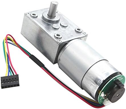

After extensive testing, I have come to the conclusion that the Hall Sensor on one of my motors must be faulty. It is encoding the movement of the magnetic disk 1,5x the actual speed.
These are the motors I am using:
Does anyone have experience with changing the Hall sensor? Would it be possible to desolder it and put a new one? I had asked in a local electronics shop, and they told they haven’t seen a 4-pin Hall Sensor as the one on the motor before.
I would also need help identifying the sensor… There are numbers on it, that I noted down:

If it is encoding the speed at 1.5 x the actual speed it seems to me like that wouldn’t be a sign that one of the hall sensors is broken, more likely that the gearbox has a different ratio or that the magnetic disk has a different number of poles. If one sensor was broken I would expect it to simply not update the position, but I could be wrong since I haven’t seen one fail before.
What are the reasons you know the sensor is to blame?
The picture of the Baumarkt shows the YC-52010. Is that not the encoder on your motor?
The reason why I think its the hall sensors are the followig:
  1. I had exchanged the magnetic disks on the two motors, and nothing in their behaviour changes. So i concluded the disks are equal.
  2. I had opened the gearboxes on both motors and counted the tooth. They were the same.
  3. Both motors are YC-52010.
In addition I was also suspecting the hall sensor, because on the faulty motor, the sensor has a little bit of play. It easily bends back and forth
The problem might be a poor solder joint, or cracked trace on the encoder circuit board?
Great suggestion @blurfl. A faulty connection could give strange results.

Thank you @blurfl for the leads, I will look into it this afternoon to see if I can improve the solder joints on the back of the PCB!

Do you mean the spacing between the magnetic disk and the hall sensor? I had tried to adjust that senor a bit, but couldn’t find any difference in the behavior of the motor. Which makes me think that it might actually be a cracked trace on the encoder circuit board as suggested by @blurfl
There are actualy two sensors in the package, and they need to be out of phase
with each other by a specific amount.
@dlang are you referring to the layout of the original motors? Because as far as I know, the one that I have, that I referred to on the top, only has one sensor.
I am attaching an image, because there is some spacing between the sensor and its socket (is it a socket, or a second sensor?) The functioning motor doesn’t have that spacing.

Your hall sensor is just two hall sensors in one case. 4 pin wersion of dual hall sensor.
