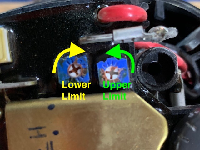

I was able to get the low speed down to 8,000RPM by turning the pots. Haven’t made serious wood chips with it yet - couldn’t say what I’ve done to the speed control feedback settings. A quick freehand cut in a piece of ply ‘sounded OK’.
One pot seems to set the lower limit, the other the high limit. I turned them to their limits in the directions shown here.
Router%20tweaks
