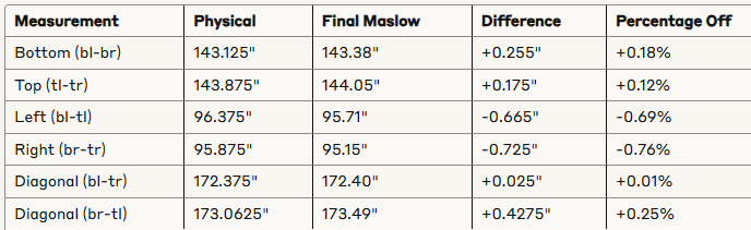

I re-ran my calibration for a horizontal setup to see if the machine would calibrate more closely the 2nd time. My machine calibrated on a 9x9 grid with a final fitness of 0.9245873289374754
The final calibrated measurements were

When I measured by hand, I ended up with the following
  • Bottom (bl-br): 143.125"
  • Top (tl-tr): 143.875"
  • Left (bl-tl): 96.375"
  • Right (br-tr): 95.875"
  • Diagonal (bl-tr): 172.375"
  • Diagonal (br-tl): 173.0625"
which matches the following coordinates
  • bl: (0, 0) mm
  • br: (3635.38, 0) mm
  • tl: (34.06, 2436.62) mm
  • tr: (3657.31, 2447.15) mm
The calibrated measurements are off from the hand measurements by the following
The calibrated frame size is squished in the y direction and just a hair wide in the x direction.
I wanted to test this by cutting some shapes using the calibrated measurements. When cutting a 9" square (using Krabzcam Profile Outside), I ended up with a rectangle that is 9" tall by 9-1/32" wide. This is oversized in x by 0.346% and spot on in the y. I would have expected a different result based on the comparison of the physical measurement to the calibrated. If the calibrated frame is shorter in y than the physical frame, I would expect everything to cut larger in that dimension. Am I off in this assumption?
