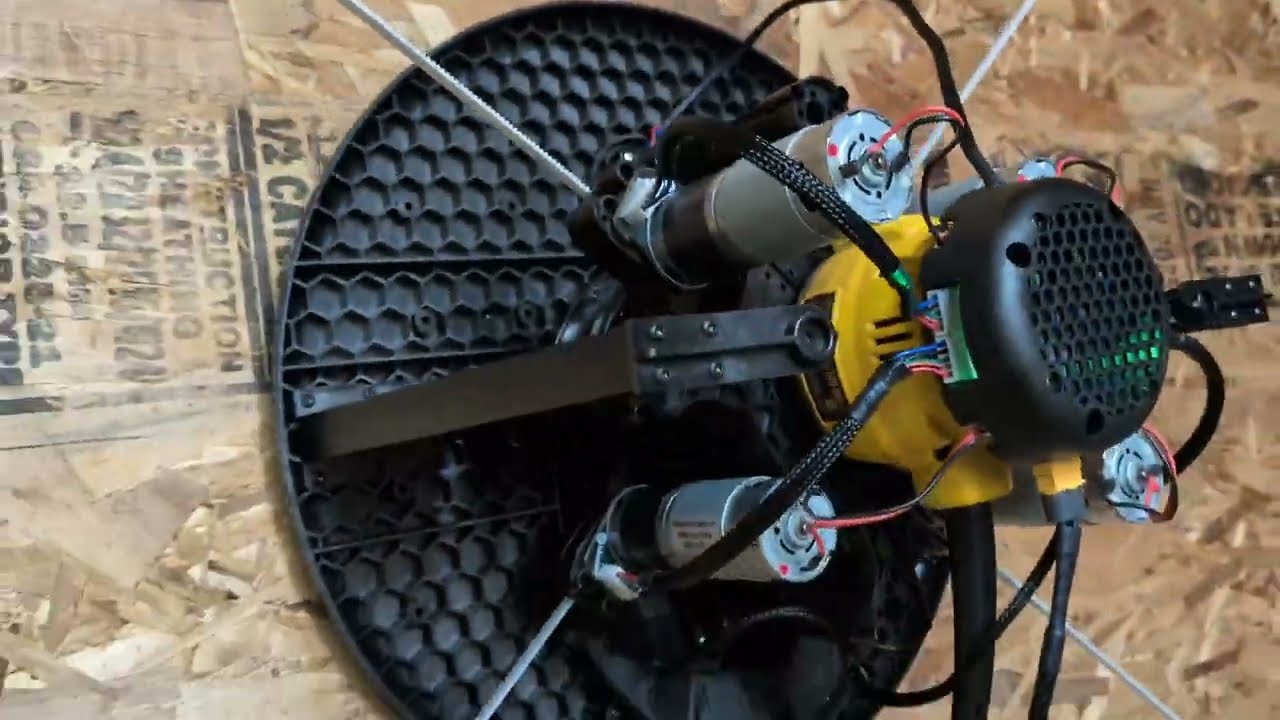

Hallo there, would like to share about my not so fancy European style setup.
My car wont fit a whole sheet of plywood and to get it delivered also costs an arm and a leg, so my setup is a little smaller with a working area of 1350 x 900 mm defined by the space I have available after simulating with the layout simulator. Anchor Point Layout Simulator
This is remarkably space inefficient and also means you do not necessarily need a full rectangular frame so i designed it in a H form with some OSB wings to stiffen it out which works well in practice.
To get started there will be a few 3D prints required that can be found all over the place, first the holder for the European version of the DeWalt router so the cable is not in the way:
The Button pusher:
https://www.printables.com/model/875193-button-pusher-for-maslow-4-cnc
And the dust extraction insert otherwise the dust does not get extracted properly from the cuts for me. Some use this as a feature with downcut bits to not use holding tabs but I am not brave enough to try that out.
So lucky who has a 3d printer. There is an advantage of the metric system in that we can get endmills in millimeter steps, provided you have the matching collets which are not super abundant for the DeWalt:
I use a 4mm mill which is a good compromise to reach the cut of depth i need approx. 18mm max, small diameter for some details, wont break off easily and still workable within the rpm range of the Router (use speed 3) at 2000mm/min, i plunge 4mm, more could be possible but I am also not brave enough to try it out :).
As software I use Inkscape, Fusion 360 or the good old Sketch up 2017 with a plugin called OpenCutList that allows to directly export .svg. files. For creating g-code I use Estlcam which so far has never let me down and is relatively affordable.
