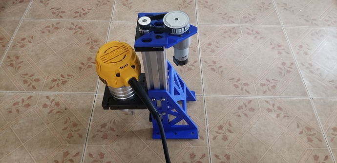

Few weeks later…Z-axis upgrade happened

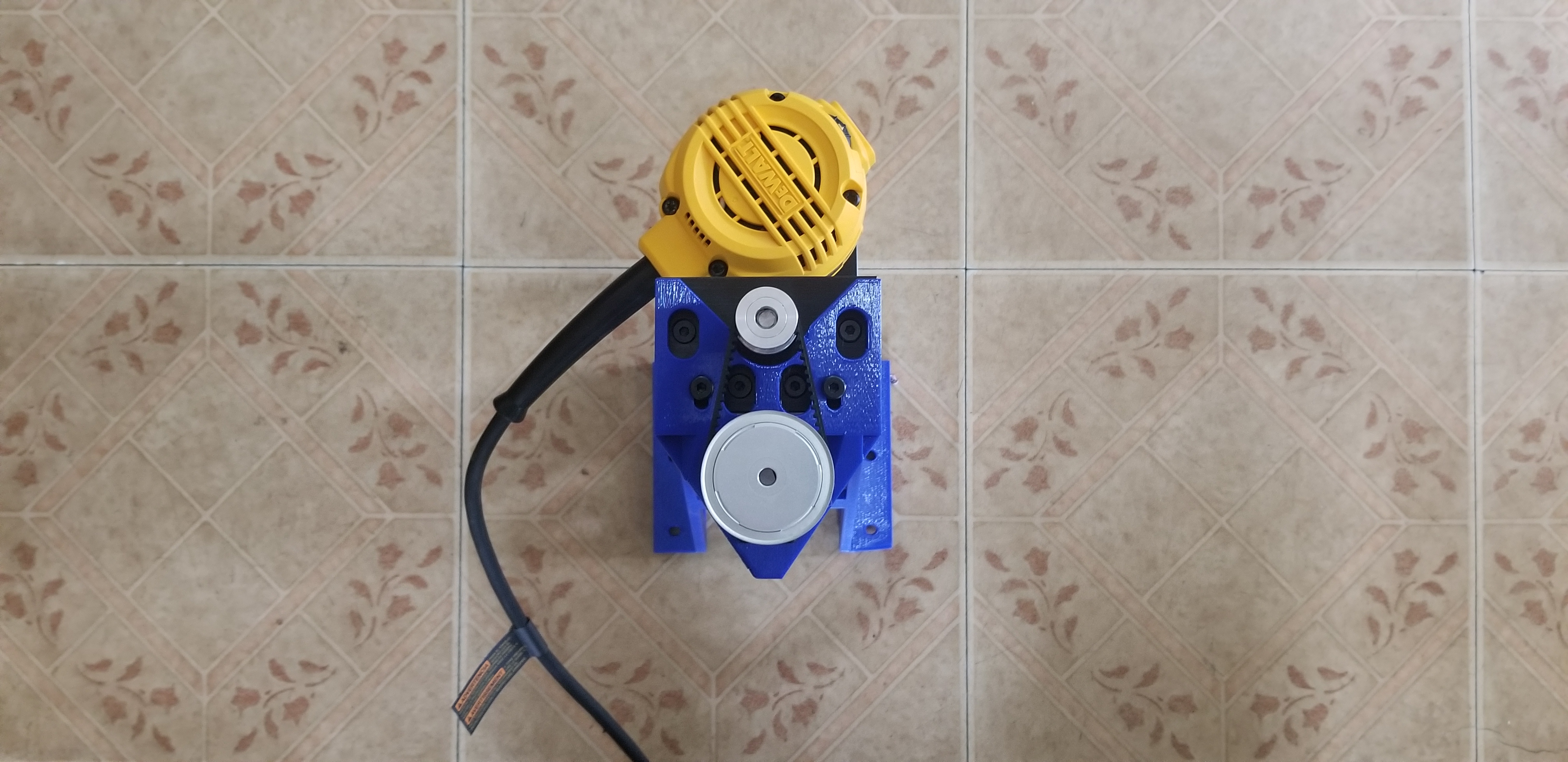

After a ton of reading and dreaming I was ready to build an Auto Z axis. The style and simplicity of the C-Beam was stuck in my mind. Someone once said “You can’t put a price on something that makes you smile”.
After spending some time in CAD trying to figure out dust collection, placement of parts, and off the shelf components that could be used with little modifications. This is the final design.
Since I was already ordering from open builds, I used them to source most of my parts.

  • Dewalt rougher clamp
  • C-beam 250mm rail system
  • 1 Ă— 3GT (GT2-3M) Timing Pulley - 20 Tooth - 9mm Belt - 8mm Clamp Bore
  • 1 Ă— 3GT (GT2-3M) 9mm Timing Belt - Closed Loop
  • 2 Ă— Tee Nuts - M5 (10 Pack)
  • 2 Ă— Low Profile Screws M5 (10 Pack) (12mm)
Parts list for SDP-SI (gear and pulley company)
6A53M045DF0906 (45tooth pulley, Motor side)
6A53M030DF0906 (30tooth pulley, Motor side)
Bought two different sizes so that way I can change the speed if needed.
McmasterCarr
95462A029 - Grade 5, Zinc-Plated, 1/4"-20 Thread Size
92210A546 - 1/4"-20 Thread Size, 1-1/2" Long
92141A029 - 1/4" Screw Size, 0.281" ID, 0.625" OD washer.
Vacuum attachment
Designed and 3D printed by me.
C-Beam holding bracket.

That is a cool looking z axis. How long was it to print? Lots of great pictures. Are you not using the full width of your top beam because your chains aren’t long enough?
Thank you! The dust collector was 9 hours for both halves. The C-Beam holder was 9hrs and the motor holder was 2 hours.
I am not using the full length of the board on the top because I wanted to build the standard machine and get that working first, but still have the option to upgrade the size if needed.
