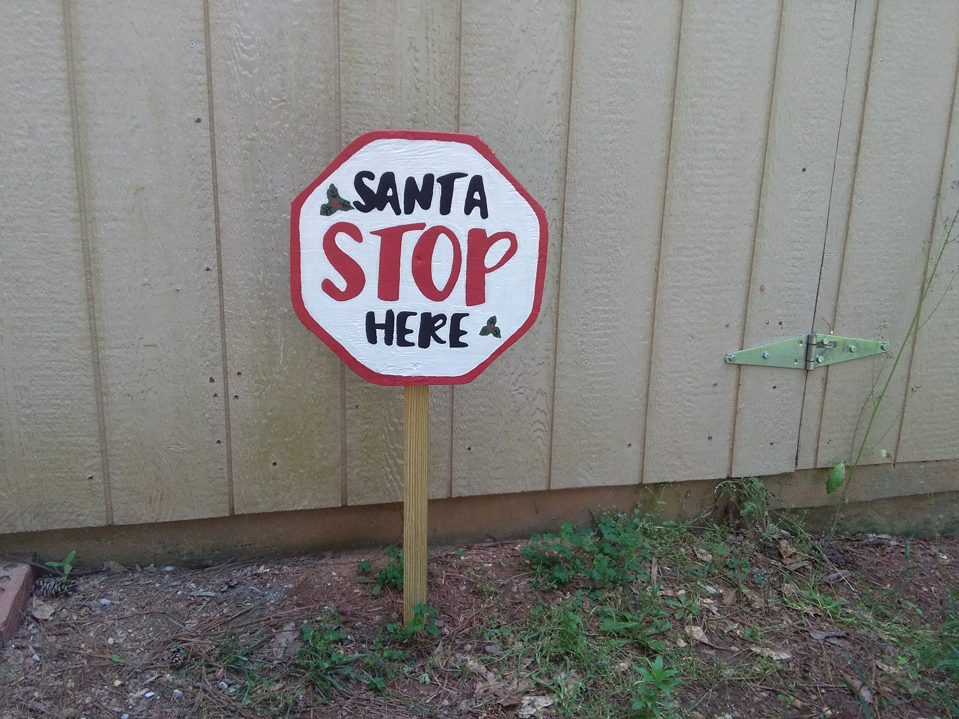

First is the Santa Sign. I made a Sharpie holder that was designed by @krkeegan here https://forums.maslowcnc.com/u/krkeegan. The inside lines were drawn with a Sharpie. I hand painted all of it. Hindsight, I should have painted it all white before cutting it.
I modified the pen holder because the dimensions were off a tiny bit. I assembled it together and it was too wife. I sanded it down to fit. I added an extra piece to the end to allow the marker to extend further and because the holes were too big. The hole that was added was cut the same size as the tip of the sharpie. This acts as a stop to the sharpie. The top was placed on the back to fill in the gap. I cut grooves on the top piece to secure the rubberband. Finally it was all assembled with glue and secured with brad nails.
This is how I drew out the inside lines: in makercam I set the tool path to a different size to allow for a tool change (I used .3 as the setting), I set the depth to -0.3 and the step down to 0.3 (to only draw one pass). I did have problems with the lines jumping. I strapped the router to the base and it seemed to just be the difference in weight.
