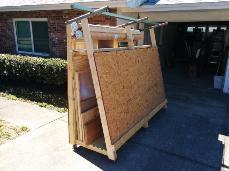

Here is the frame that doubles as a plywood cart. I was picturing this stretched into the dimensions of a small greenhouse shed, with shed roof, Maslow sled on the outside wall with a glass door. I’ll try and find the enclosed Maslow with the glass door. So end door allows access to plywood storage, counter weights, dust collection, electronics etc. Glass doors open up for insertion of plywood, from the outside wall, normally where sun would enter greenhouse. Yes, this is what happens when I’m locked up at home.

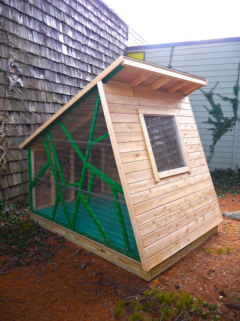

Here is more what I meant. It is 6x8, if you lengthen the 6 foot side to 10 we have a built in sloped side to hold a sheet of plywood. Pardon the pun, thinking outside the box :slight_smile:
