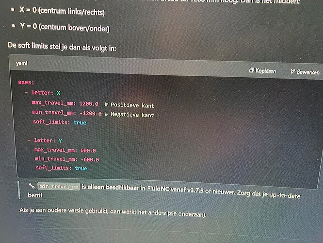

Another follow on question with regards to soft limits in fluidnc;
Reading up on the fluidnc wiki and throwing some question at ChatGPT, it seems to be possible to add an “min_travel_mm” to the “max_travel_mm” of travel axes as of fluidnc version v3.75. This would make it possible to set negatieve and positive limits from the home position (machinebed center).
What version is Maslow fluidnc version 1.06 based on? Is it pre v3.75 or post?
Latest version on fluidnc github is 3.9.7
Waldo

So I set up my horizontal workspace in my future bedroom (remodeling our farmhouse.)
Tried to setup the x and y soft limits. But did not manage to get it to work how I would like it to work. When setting the machine home/origin in the bottom left corner and then setting the soft limits to cover just a bit more than the 4x8 osb sheet. It does not respond the way I expected. The machine stopped after moving after about 2 feet from the bottom left corner in x and y. After having set the machine offset to the center of the sheet again the machine stops after 2 feet in either X and/or y axis.
Maybe in the future when the S3 support is fully stable it will be possible to setup the soft limits from the center of a 4x8 sheet with negative values, but till that time I’m just g
oing to work with a checklist so I don’t accidentally jog my machine beyond the limits and snap more belts! On the other hand happy with the first test cut with my Maslow4.1!
