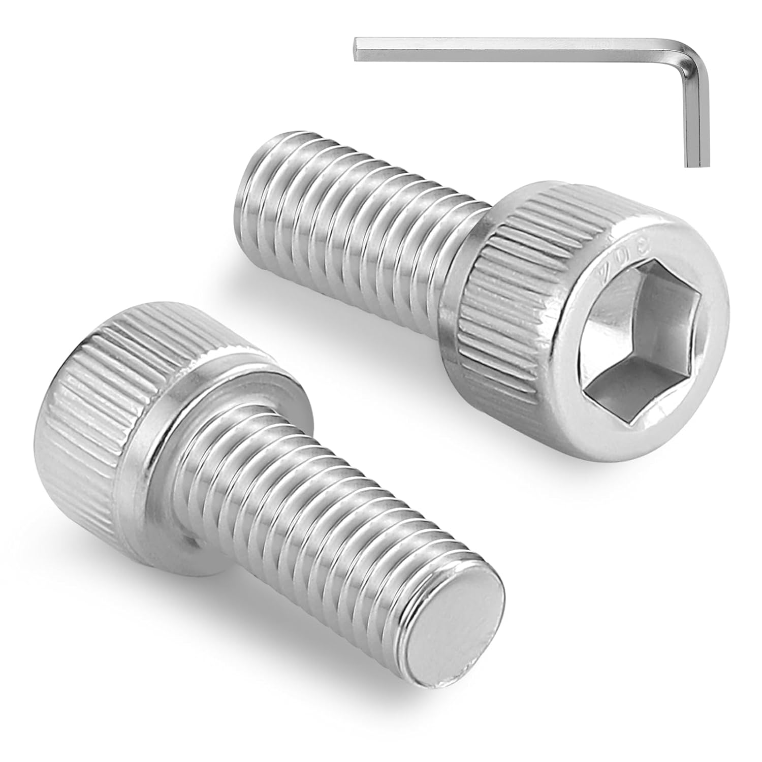

I also strongly suggest these bolts, they take a 2.5mm hex, but fit the holes
much more easily than the button head bolts (and the extra length better engages
with the lock nuts)
