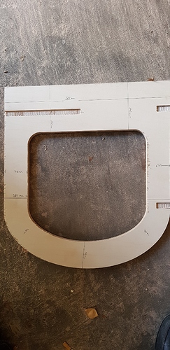

Can you tell us more about what happened? Is the issue those lines over to the right which don’t meet in the corners?
Well, we see several issues! :frowning:
  1. When you see from left to right: the whole cut sags, but should be parallel to the edge of the board.
  2. the cuttings are not square! even the rectangle cut in the center, partly below the sledge is 2mm out of square. the “D” shape left meassures are about 1.2cm out of square.
  3. the rectangle on the right meassures are out of square similary.
  4. the “2 lines” are pockets and as well not parallel to each other …
I’ve stopped the cut to not waste any more material …
We are using the lastest firmware/GroundControl versions …

I just checked the meassurements for the “D” shape on the picture above and below and compared it with the design file.
Here are the results:
There’s a big discrepancy between the designed 530mm and the result 507 mm respectively 516 mm. This is an inaccuracy of 23mm and 14mm!!!
Same for the 78 mm and 67 mm, which should be 75 mm…
Maybe this discribes the problem a little more in detail?
Here’s the g-code, in case this helps for the findings: Pilates-Chair - Details - Teil I - Kopie.nc (24.6 KB)
I am fairly certain that something is going very wrong in the calibration process. That distortion pattern you are seeing where a straight line from one side of the sheet to the other bends up is a classic symptom of something being off in the calibration process.
Check out the simulator under advanced options in Ground Control, it’s a fun way to play around with adding distortion to different measurements and seeing how the affect the cut.
The first place I would look to fix the issue is to measure by hand and make sure that the measurements for the distance between the motors and the ring size shown in the settings match up with what you are seeing in real life. Those two measurements are the critical ones. If either one is off you will get the sort of distortion you are seeing.

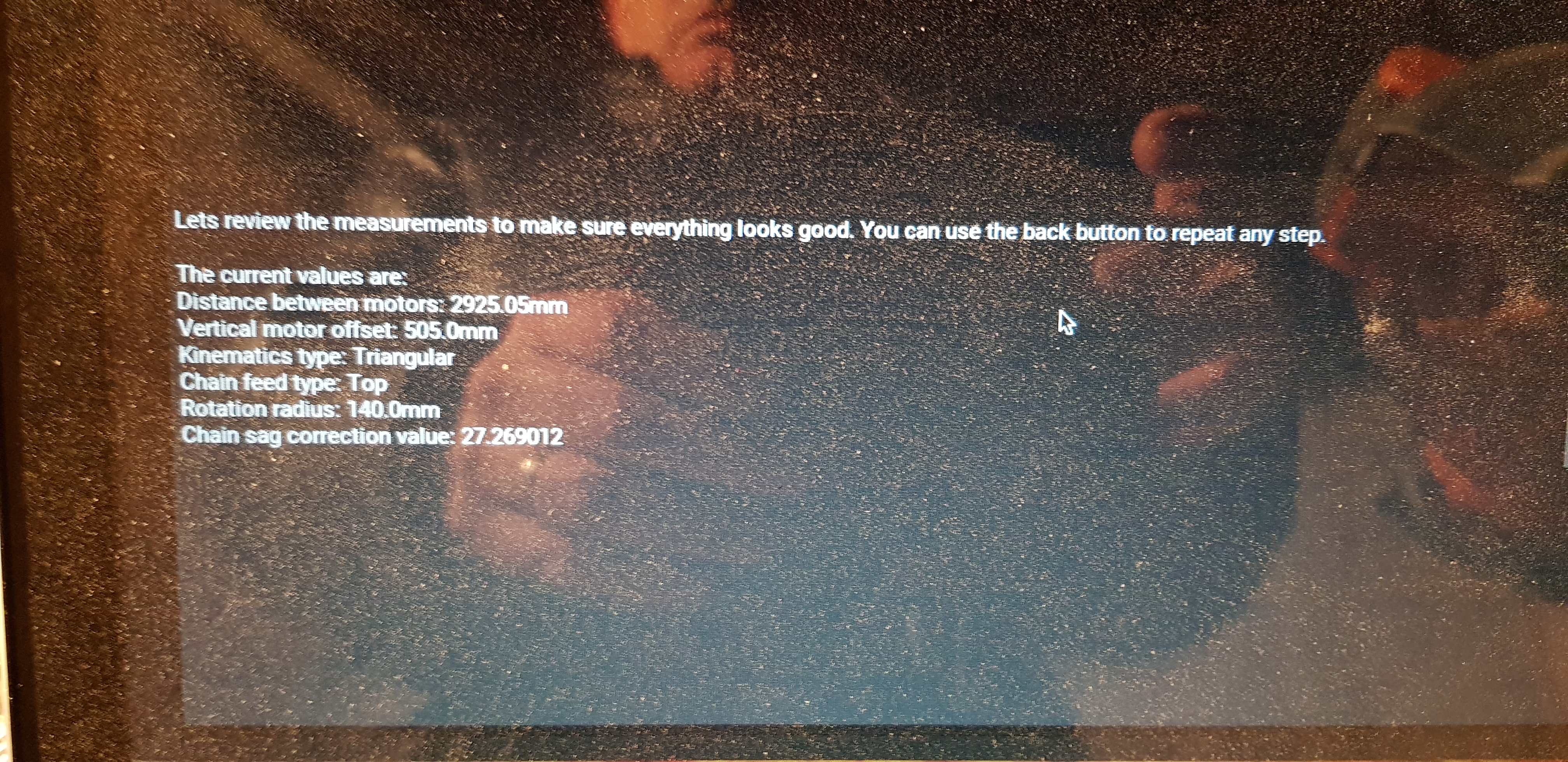

I spent almost the total day today to calibrate my Maslow. Unfortunatelly to no avail …
Some facts upfront:
We build a steel frame with a lenght of the top bar being 3000mm.
Center of sprocket is equally 26mm from the left respectively right edge of the top bar.
Hence, this means that the distance between motors must be something around 2948mm. Am I right?
However, first I’ve tried to do the calibration using our RasperryPi. But this was always “hanging” after the third step of the procedure, so I connected my Macbook, which was running fine.
By the way, the RasberryPi reported a version mismatch of GC Version 1.28 and FW version 1.26. The Mac has GC 1.26.
In total I did 14 calibrations, but none results with the same distance of motors!!!
Furthermore, I had to reset the Arduino after 4 runs, it simply didn’t respond.
Below all results incl. screenshots!

The eight calibration meassured the motor distance being 2925.05mm:

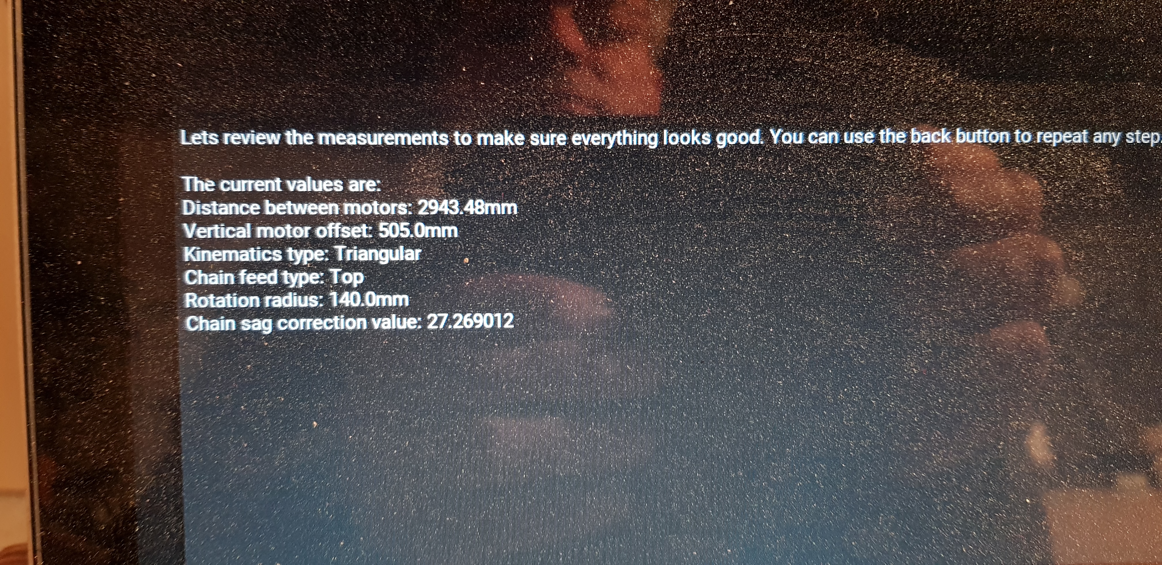

The eleventh calibration meassured the motor distance being 2943.48mm:

When you say you did the calibration multiple times, did you do the ‘full’ calibration where you measured the distance between motors by stretching the chain across the motors?
Well, I’ll answer my own question since you must have since the distance between motors is not optimized during calibration.
I’m not a fan of ground control’s method of measuring distance between motors. I never could get consistent (or accurate) results. I suggest that if you know the exact value between the two motors (2948 mm) go to Settings and enter that value. When you go to calibrate, press the skip button when it wants you to measure the distance between motors. It will use the value from settings.
OK! My assumption distance between motors is meassured between center of sprockets is correct?
Yes. Center of sprocket to center of sprocket.
I think that sounds like the issue for sure. Those numbers should be the same to within a fraction of a mm. It worries me that they aren’t, as in possibly something else is going on…potentially a loose connector.
I agree with @madgrizzle that the right course of action is to use the number you know to be right, but let’s not forget that something could be up with that measurement not coming out accurate.
