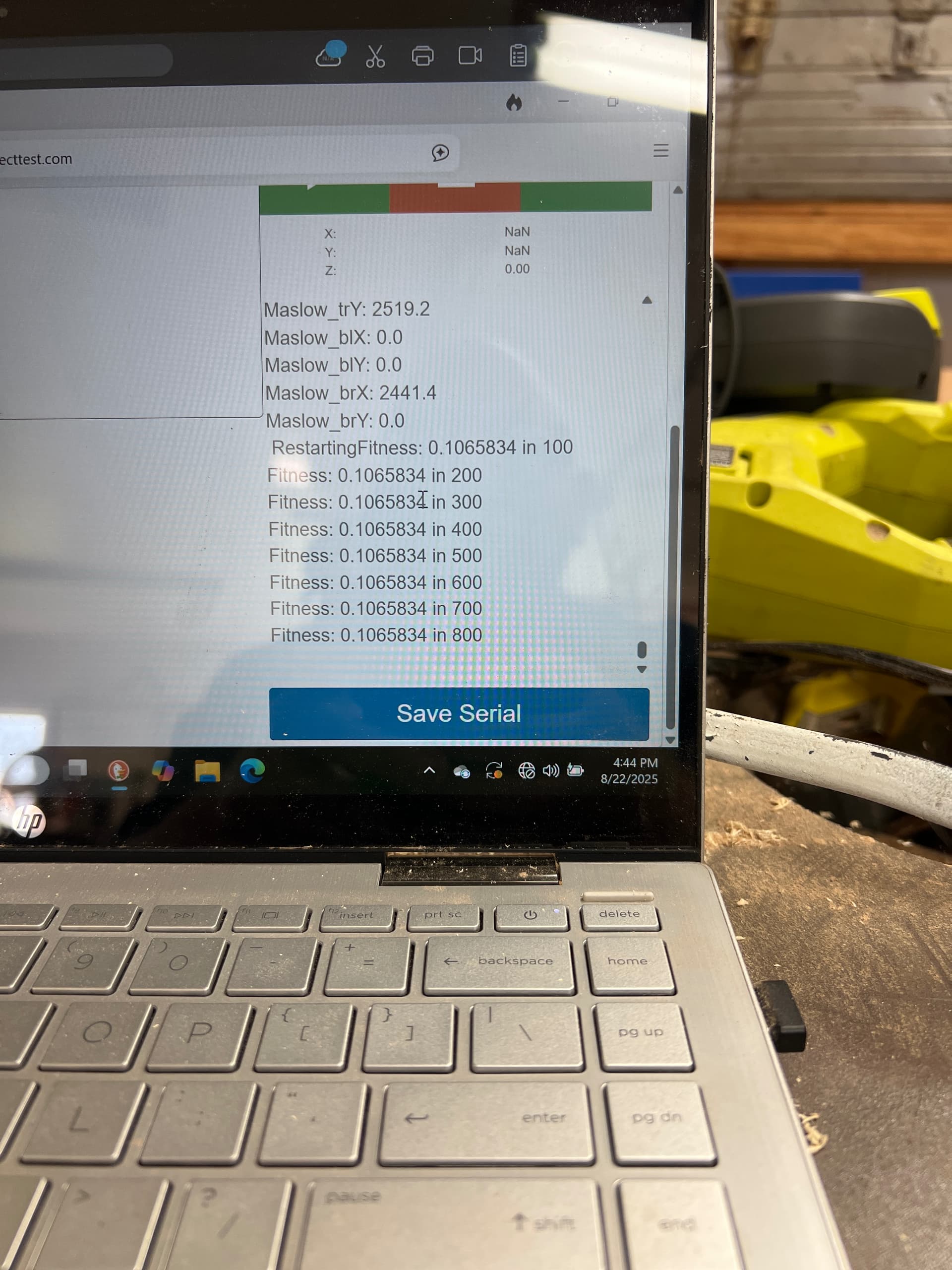

How many times does the fitness restart?
It keeps showing calculated fitness too low, automatically restarting fitness. Over and over again.
When the fitness is really low, it will never complete (<0.2 is where we tend to
see this)
This usually means that it has some bad measurements (either the first one is
bad on horizontal frames, from frame flex, from a belt catching on something, or
bad Z offsets. not a complete list)

Can you put up a copy of the latest log file (where you have tried to calibrate )
I don’t believe I captured that. I started over this morning and it seems to have gone a lot further than yesterday. Once it is complete I may attach that file.
Fitness is up over 87000 at the moment.
Maslow-serial.log (49.2 KB)
I spoke too soon. Attached is the log.

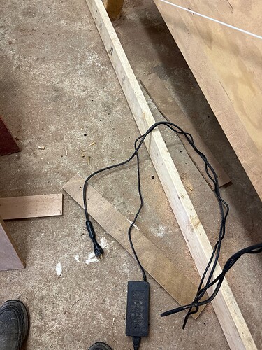

Now it is self destructing and spitting pieces of plastic out. All Thea specks of black are pieces of plastic! It stopped and started making grinding noises!
Somehow during the calibration it pulled the belt up Into the gearing and wiped out several gear teeth. On one of the spools.
That can happen :confused:
The new belt guards help to keep the belts out of the gears but they aren’t fool proof :confused:
I will DM you a code for a free replacement right now.
