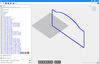

Tool paths from MakerCam not showing up in Ground Control
I had trouble before due to the browser I was using. Try to switch browsers, maybe that helps.
don’t know why it didn’t work for you, i used the most recent version of makercam
http://maslowmakercam.000webhostapp.com
with .25 in bit size, .5 in depth, .125 clearance
18 in tabs
and got this:
test.nc (30.7 KB)
edit: tossed it into ncviewer.com and it looks like it worked:

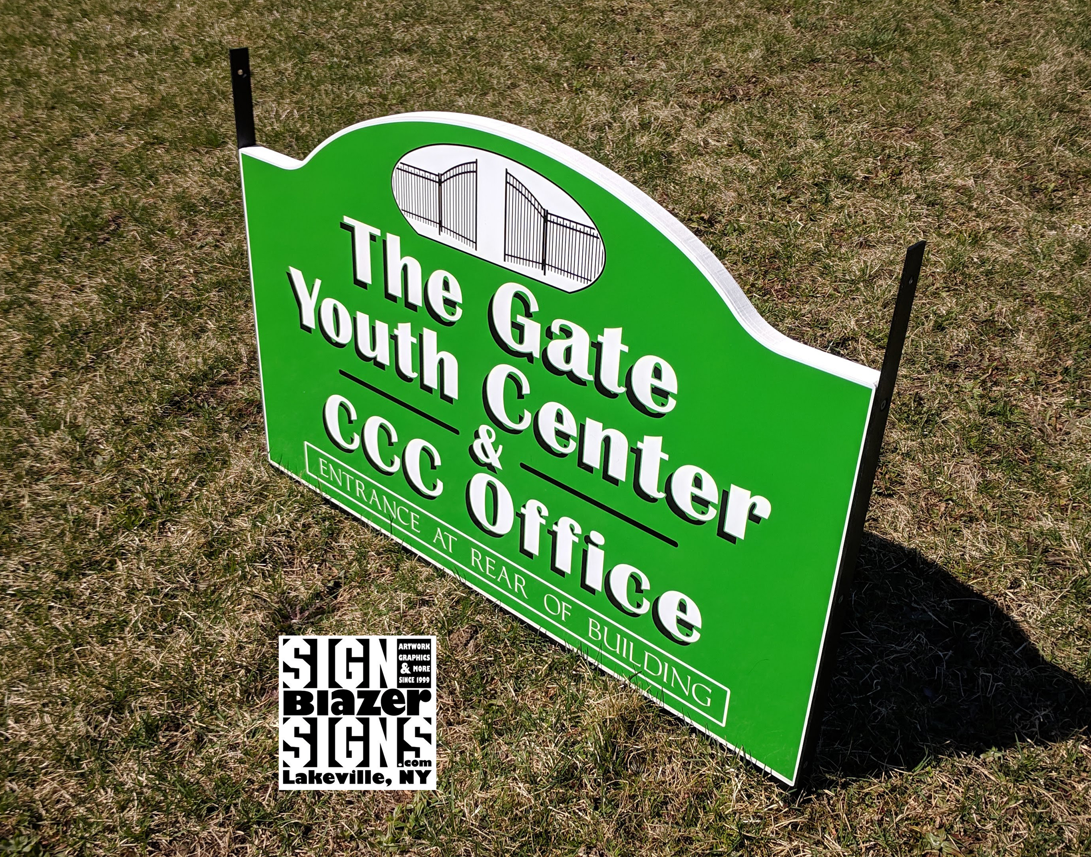

The finished product.
Thanks to everyone who helped!
