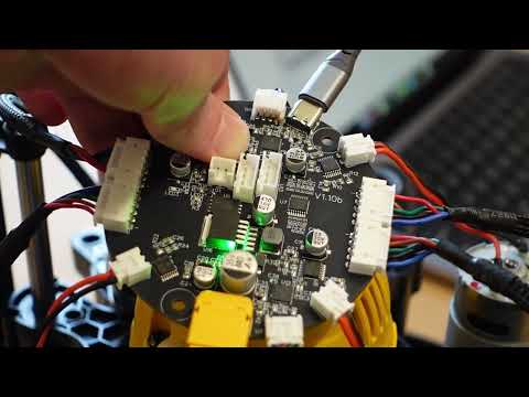

I have seen this error before too. There is a black button on the control board (you will probably need to take of the cover with the fan to see it). Holding down that button will put the board in ā€œboot modeā€ which will make it easier to program. To get it to work the order has to be hold down the button and THEN plug in the power (while keeping the button held down)
That worked for my part also when I connected the board to my PC at home. Thank you David!

As I still found myself cursed with the ā€œFatal Error. No serial data receivedā€ message, I figured I’d do a fresh install.
I put my board in ā€œboot modeā€ with the button held in while powering on.
I then successfully ran the installation with the files from release 1.01.
Connected with no problems, and did not get any error messages.
