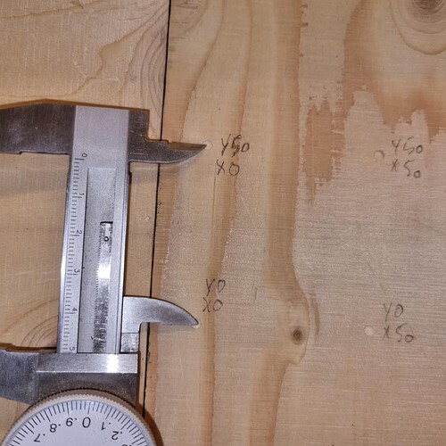

I did our first cut today with FW 1.01 and index.html.gz 0.88.
It was just a 200mmx200mm square, but I’m very happy to see it moving AND cutting!
The sound is horrible, but running a 1/8" corn-cob cutter in soft wood is not going to produce any sweet music at 12000rpm I’d guess.
It was the only one I had available, and I just couldn’t wait any longer. I’m hoping to get my real cutters tomorrow, but most likely they will arrive on monday.
Keep your cat away and turn the volume down
A test done with a flat mill shows that the vertical axis is more accurate than the horizontal.
I also tested jogging 50mm in all directions with the same bit.
Not sure why the bottom line isn’t straight. It might be because the material has a little bump there, combined with a Dremel bit that’s really not meant for this.
