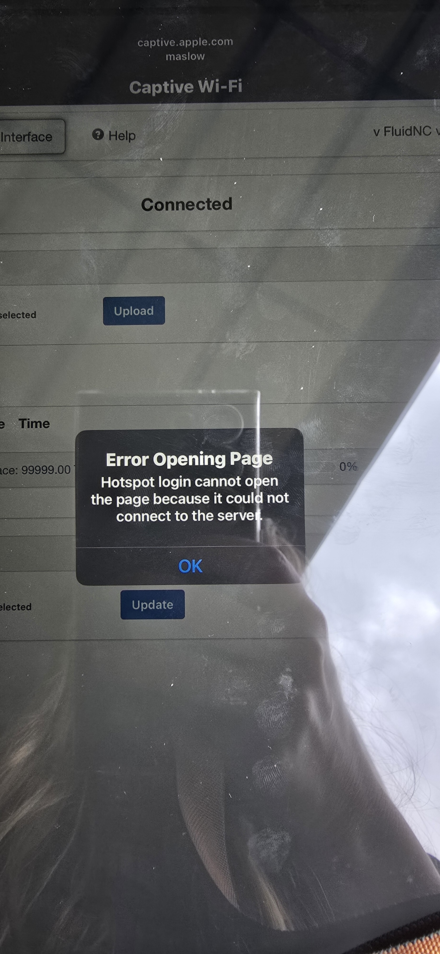

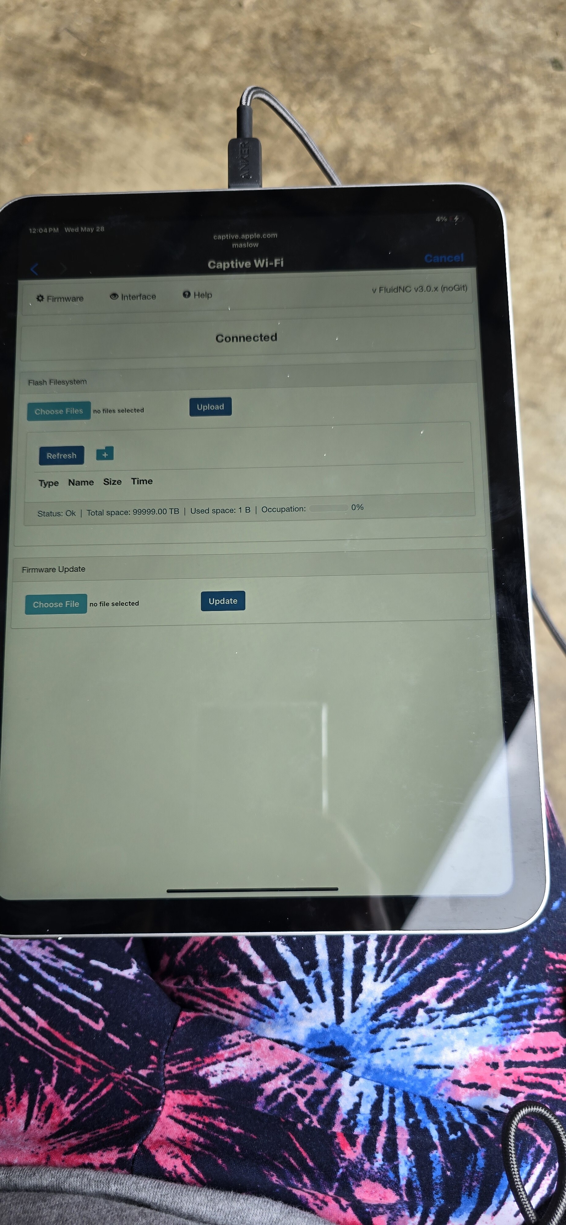

Well here is my experience on Mac and iPad…I get the following screens. Is there something that I need to download to these devices to make this all “talk?”
Rayn
(attachments)
are you trying to use the maslow through the browser that pops up when you
connect? that browser is frequently crippled. you need to open a new browser and
open the page through that.
This looks as if your system is detecting that it can’t get to the Internet and
assumes that this is because you are behind a login (like you would be at a
hotel or coffee shop) and is trying to get you to login to it. There is some way
for you to tell it that you really do want to use this connection, even though
it does not have Internet access. That is different for different systems and I
don’t know how to do it on your system (hopefully by describing what’s
happening, it gives you info that you can use to find a fix)

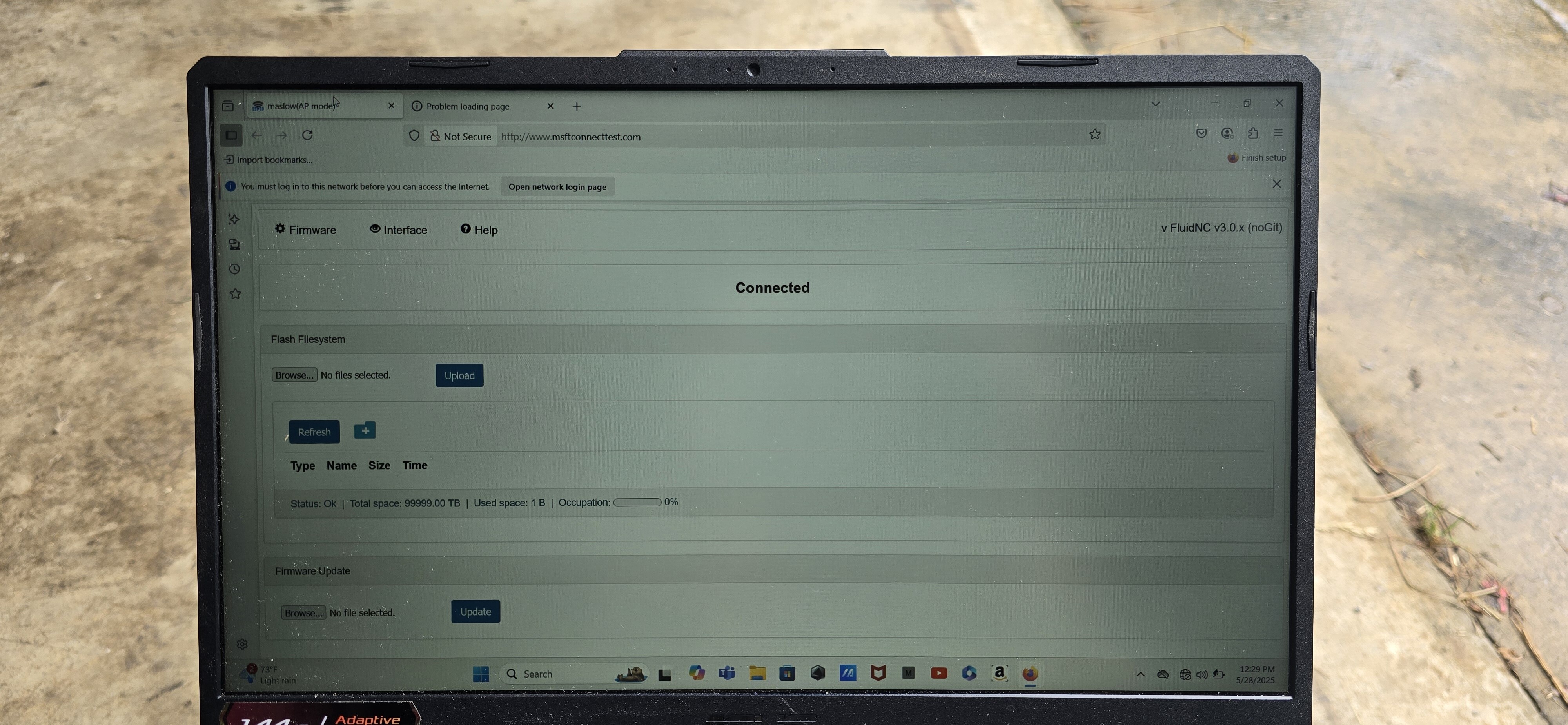

Now this is the screen I see even on my Windows computer?!? Did the website crash while I was on it. The interface button does not work.
(attachments)
look at the URL, mftconnecttest
this is the popup login browser that I said won’t work.
type in the URL/IP address and try that.
If it disconnects, that will be because it’s test to get to the Internet is
failing and it’s going to try other networks that it sees. If it does this, you
will need to figure out how to tell it not to, or that you really do want to use
this network.
Already been there done that. Now the website seems like it’s down. See my attached photos.
This image is very interesting. I’ve never seen this page before.
What happens if you click the “interface” button at the top of that page or click the “Open Network Login Page” button?
this is a page fluidnc generates if it doesn’t have index.html.gz
it lets you upload new firmware/yaml in the top box or firmware in the bottom
box
the login prompt is because the connection to msiconnecttest.com is failing (can
we add that to the list of pages that we respond to?)
