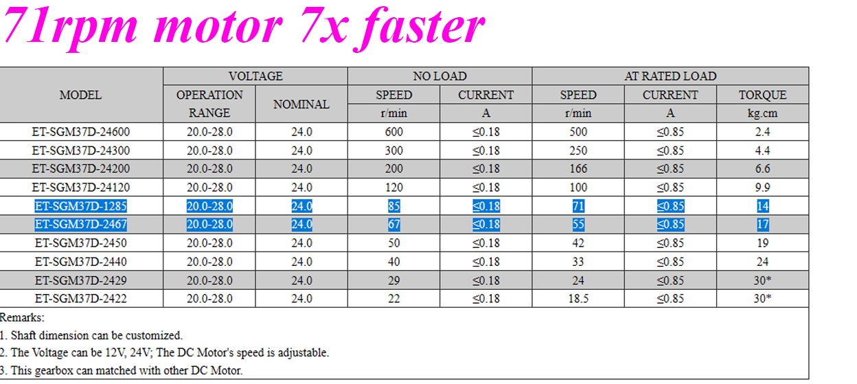

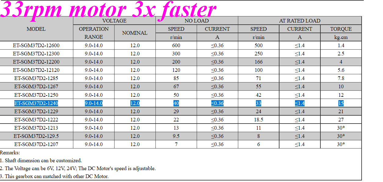

Upgrading Z motor from 12rpm to 100rpm Can TLE5206 motor shield handle 0.85A motor?
Below are several screen shots of Etonm motors that could be used to replace the stock Z axis motor, which many feel is too slow.
The first motor I think is the stock motor. Each motor chart shows the various gearing and resulting rpm and torque as well as amps drawn. Highlighed in blue are possibilities.
Our kits stock Z motor is currently 100rpm and it works fine. My gut feeling is it could probabaly be increased to 150rpm. I’m not sure anything faster than 150rpm would really save that much time? And the torque is 10kg.cm which works fine, but if one has a really tight bungee it can stall out at the top of the Ridgid’s movement.
So I think torque needs to be 12kg.cm or more. speed 48 to 150rpm.
Last two motors are a fatter 51mm but this is easily solved with a different mount
So my question is can the shiled handle 0.85amps? Any reason to go with one motor over the other? I think price will be pretty similar, give or take $5 usd.
Pink heading of rpm is wrong on the last two charts.
I think this motor is the best because it keeps the 37mm mounting hole patern and has a decent speed and torque
We are currently using the 100rpm version of this motor on a z axis,but with out a proper z axis I think more torque and slower speed might be best. Usign the 55rpm speed the torque would be the same as the stock or we could bump it up to 71rpm with a torque of 14kgcm. As mentioned above at 100rpm / 9.9kgcm torque and a strong bungee the 100rpm version can stall at the top of the routers z axis range.

Is a “bunch of motors” really required? Looking at the tables I posted only 2 seem to be the best fit. the 71 and 55rpm motor @# 14 and 17kg.cm and 0.85A max current. I can buy a bunch of motors for testing, but best to narrow it down. IMHO. Stock motor appears to be 0.55A max current @ 17kg.cm.
the 55rpm will work for sure because it has the same torque as stock motor and be 5.5x faster
the 71rpm will work too, but might require a bungee that is not as strong. 7.1x faster than stock.
Which one of those two do you think would be best for direct drive of the Ridgids Z axis? Currently using the 100rpm @ 9.9kg.cm and it works fine, but if one uses a strong bungee at the max height the motor can stall if bungee is too tight.

the variation of motor power goes from 0.55a to 1.1A. The last one actually goes up to 6A which is beyond the stock boards capacity so I guess should not be considered. Make sure you look at the current at rated load.

one more thing, you need to look at the current at the rated load, not at no
load.
those are max load amps.
Well the 55rpm one has the same 17kgcm torque as the stock and is 5x faster so if you want to be conservative just get that one. if you want to push your luck get the 71rpm one at 14kg.cm torque.
those are the two best options out of the 5 originally listed IMHO.
Those are both 24V motors? Will the shield just take 24 V or will it all have to be replaced?
they can be run at 12V. the 100rpm motor just above those 2 is the one we current use and we run it on 12v power. I am not sure if the factory changes the wiring somehow, but they do specify 12v on the label so it’s not an issue.
So if the motor wattage stays the same, then the current doubles if you cut the voltage in half or the torque drops off significantly?
if the amps doubled it would fry the motor. the speed might decrease, but I think the factory rewires them, I can run some speed tests on the 100rpm motors we have to see if speed is reduced. that is what would happen in theory and torque would stay the same. Anyways the 55 and 71rpm are the only viable upgrades I see and even if the speed is reduced still much better than stock z motor.
