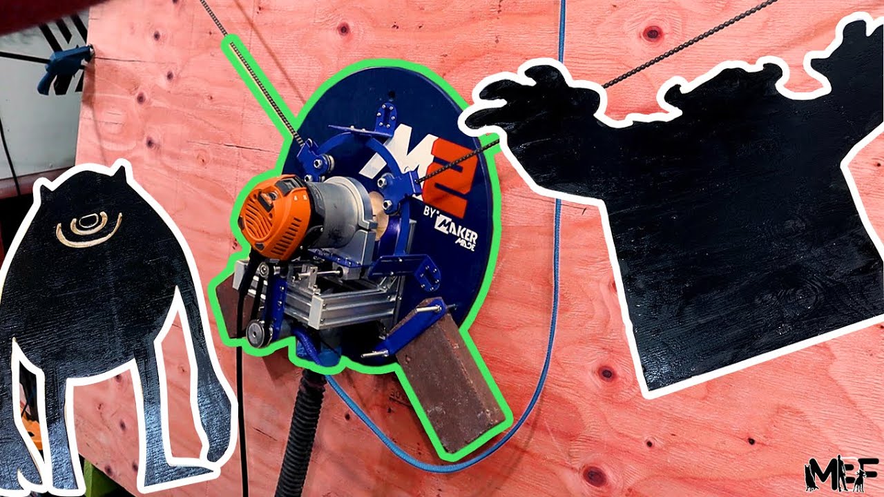

Latest video out! Making some halloween decorations with the new M2!
