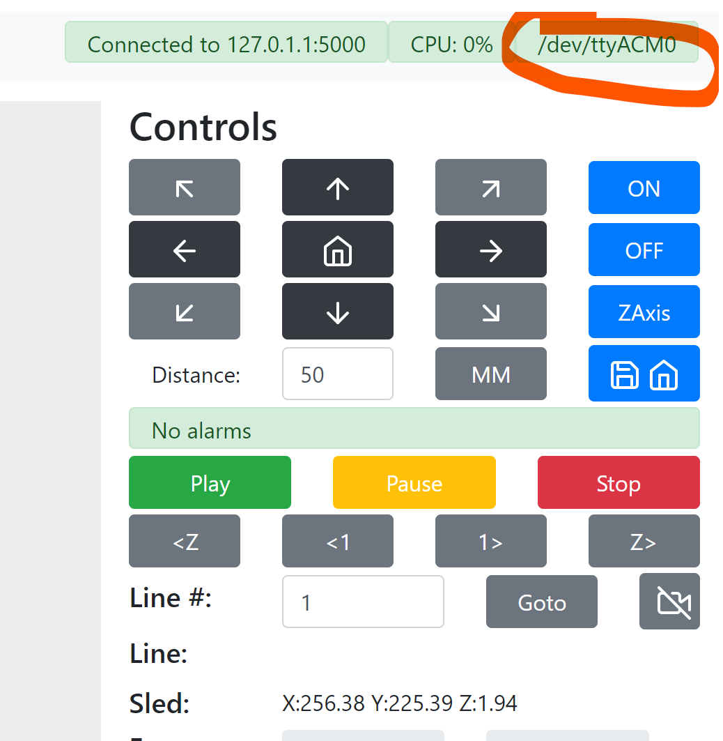

With respect to webcontrol, does it recognize your mega and connects to it?
If you move the hex file into the correct folder, does the name on the button change?
From this or Holey:51.27
to this:
If the serial port is not set up corrrectly… I have no USB port open on my pc, then it does this:
It completes in 3 seconds and yet was never connected to anything. What port is your arduino connected to?
Also the lights on the controller board will flash rapidly while it programs
Go to the menu Settings -> Maslow settings press the refresh button and select your arduino serial port, then try again.
I do have it successfully connected on COM3. And when I remove the Holey firmware from the webcontrol folder, the GUI does show None as the option- and then when replaced it shows the 51.27 (the version i am trying to update to)

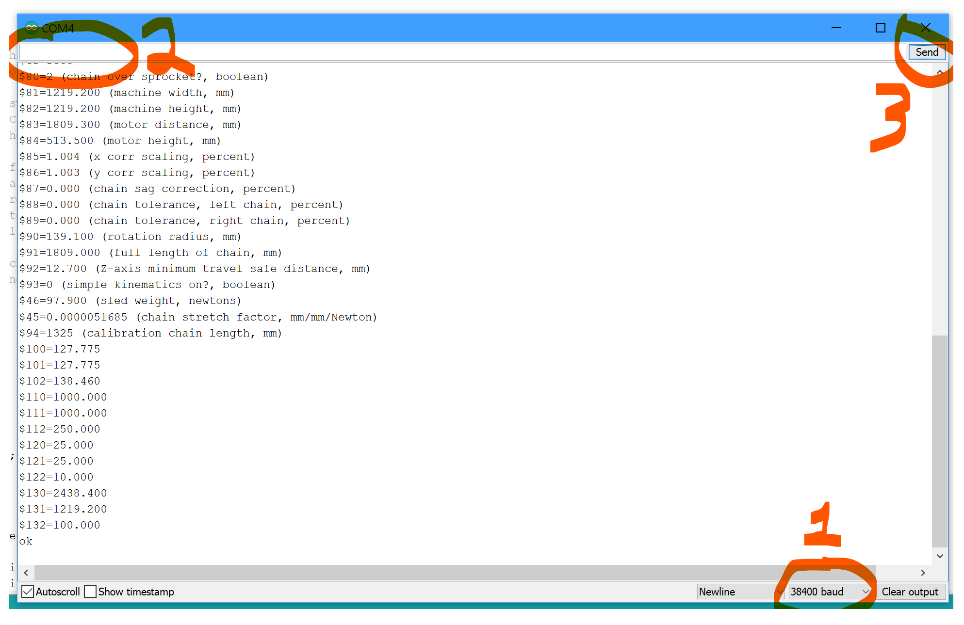

Have you wipee the memory on the arduino? (webcontrol has a button for that) or $RST=* is the command.

Start Webcontrol and use the menu ->Actions:
OR in the arduino IDE, you can open the serial terminal:
make sure you open the correct port
  1. set baud rate to 57600 for the mega
  2. enter the command
  3. click send. it should respond with OK
    if you see lines of garbage, you have the wrong baud rate.
These instructions work with the classic controller (mega). The due uses 38400, but the command will wipe its memory as well, but it will not work with webcontrol… at all.
