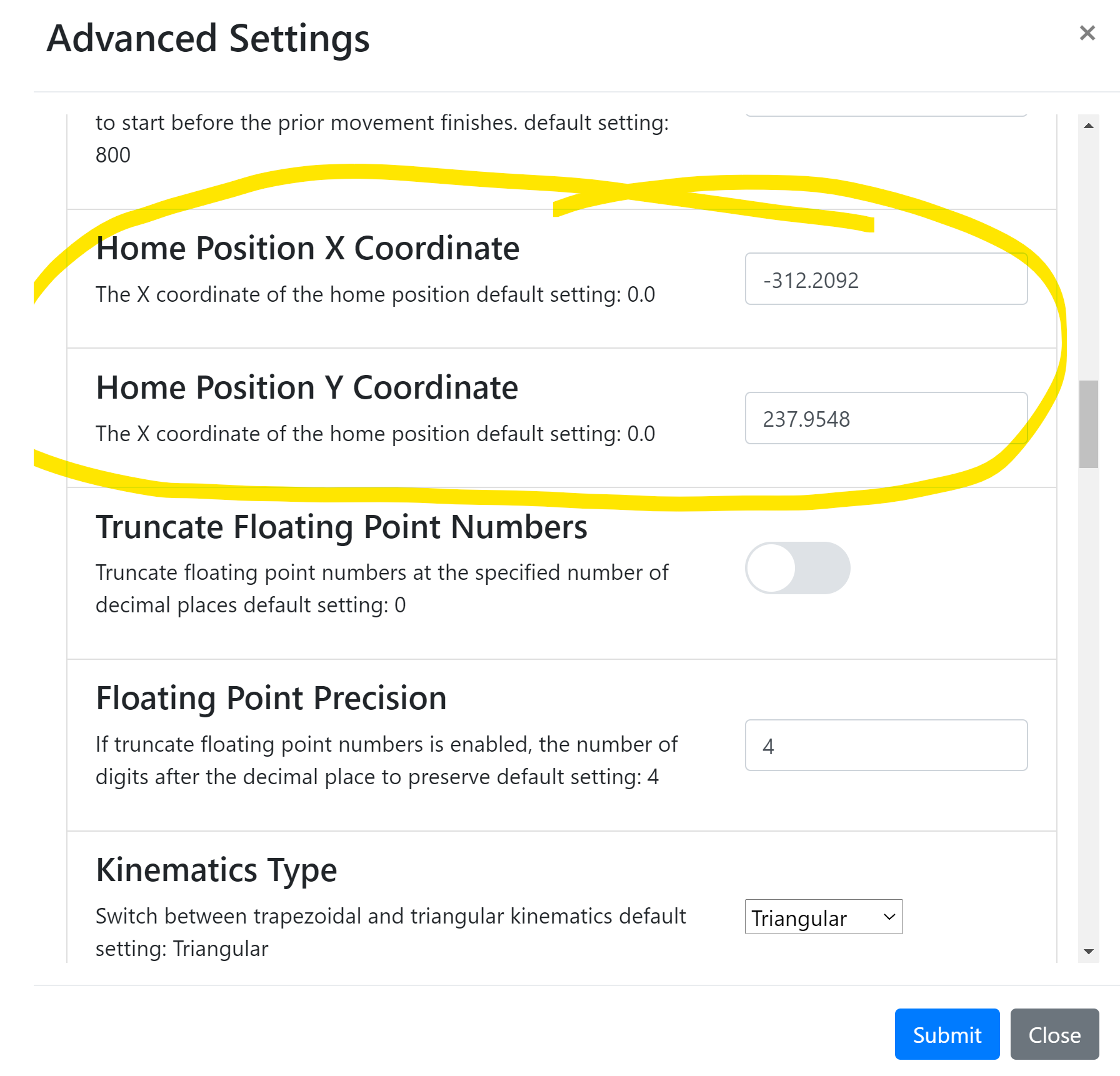

I am sorry to hear that, when I have experienced USB con loss the screen freezes on the last gcode line processed and the home position is still visable, I either take a picture with my phone or a screenshot on the computer/tablet, maybe that will help?
in webcontrol under the settings menu and advanced settings, the home position is stored whenever you set it. I have not looked yet to see when it changes in an upset condition, other than to test that it does change when you move the home position with a right click and define home.
In XY?

I’m a bit late to the conversation, but I have an issue with my Christmas lights coming on automatically when I’m cutting and flipping the breaker (took a few times to solve that one). What it does is cause my maslow to forget where it is and if i just tried to re-start, it would cut in the wrong spot (proven by experience). What i’ve learned is that the webcontrol keeps the home position in memory. I select actions > check for chain skip, which sets my sled in the position it was for my calibration. I marked my chains to ensure that i can re-position them to the same position for that chain skip. I place them back to where they’re supposed to be, find the last line of Gcode that was run, change to a G0 to get there, delete all the previous code, and then run. It usually works very well. Hope this helps!
