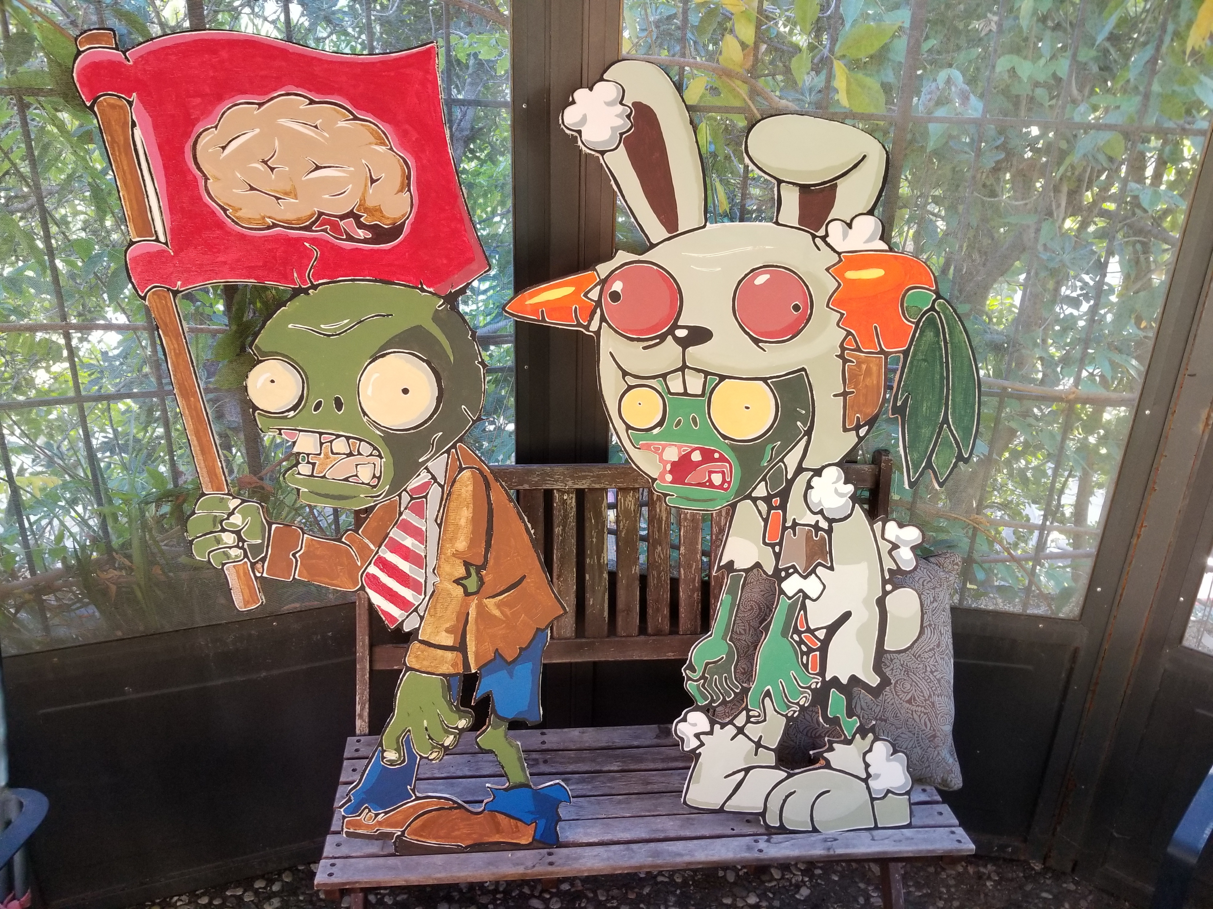

It is painted with 4 coats of exterior grade paint (3 layers of primer and then the color coat; the back has a final coat of black). From searching around the web, this covering method seems to have held up well for some folks, so I thought I would give it a try over the alternative of filling in the inevitable voids in exterior grade plywood I can source locally.
I love it. It turned out very nice.
normal MDF, not well. There is MDF made with wterproof glues that does a bit
better, but you really have to protect it outside. It won’t even hold up it’s
own weight once it gets wet.
I’ve heard about greenish water resistant MDF you can buy overseas, but I’ve never seen it in the US.
MDO is what is typically sold in the US for exterior signage. Unfortunately for me, it is 4 hours+ round trip to purchase MDO.
FWIW, we have made several pieces of yard art out of MDF for the upcoming holiday season. If 4 coats of primer/paint protect the MDF from water intrusion, great. If not, I know what my Maslow will be doing in the Spring!
Looks awesome!

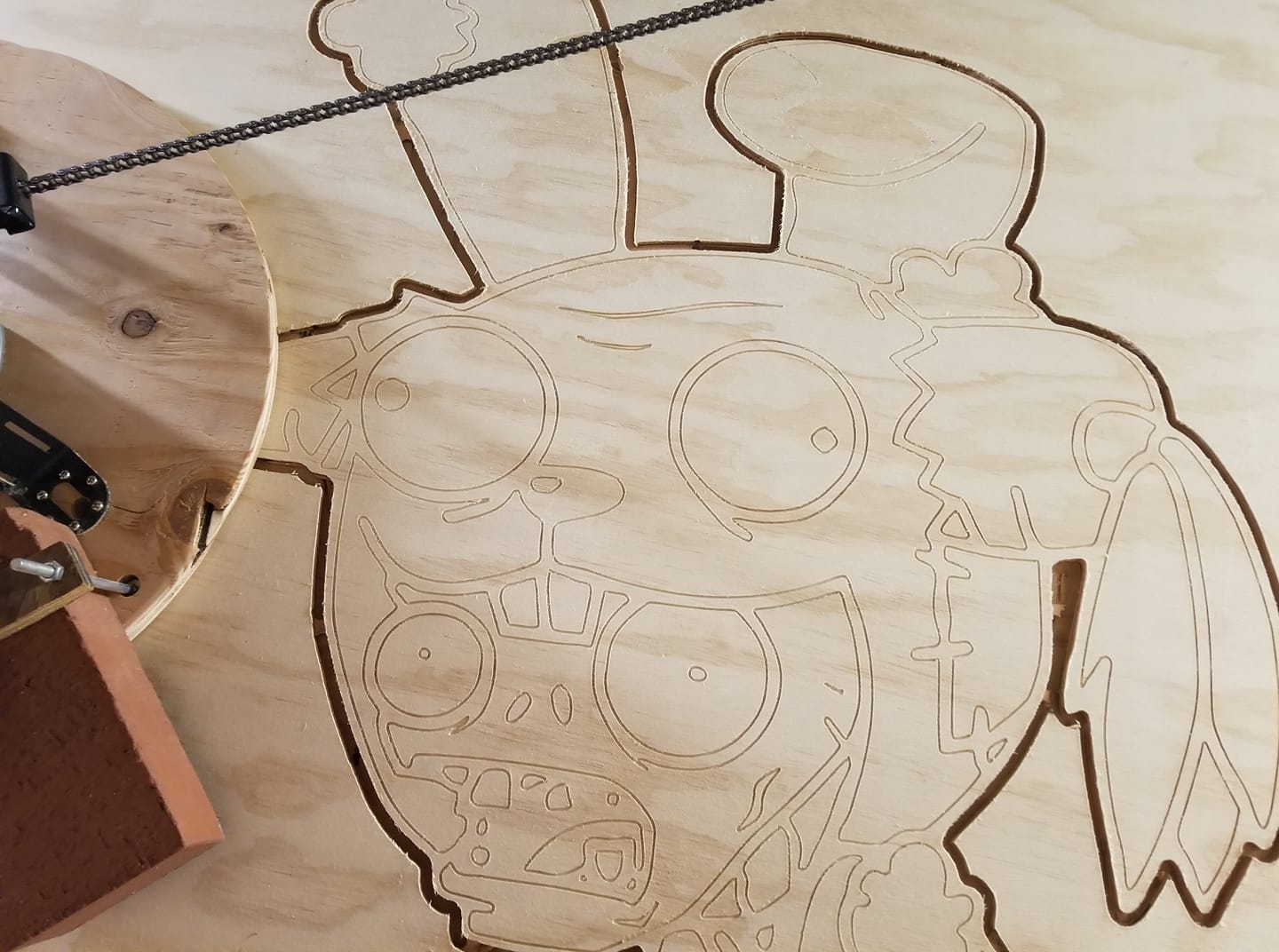

Cut a couple of cool looking zombies for Halloween.
Feel free to cut them from Fusion 360 (not sure if this link works, first time I’m trying it: https://a360.co/2oHqrAY)
Instructions:
On a centered 4’x4’ piece of 11/32 ply (ca. 7mm thick)
First use a 30 deg. pcb 1/8 vbit, 1mm deep to etch out the lines
Then cut the outline with a 1/4" downcutting bit:

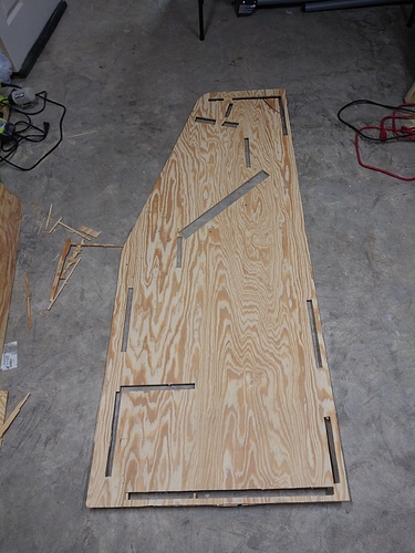

A little testing on the accuracy of bigger cuts, I decided I’ll try to cut out the side of a Dragon’s Lair arcade cabinet, being as I have 2 original cabinets that I need to rebuild due to age, and being mistreated back in the 80’s… Oh the 80’s… sigh
This cut is 72" x 30" to give you an idea of scale.
So this is intended to be used as a template, since, as I said I have to rebuild 2 full cabinets. I did some modifications on this since I’m no longer using the laser disc players in either of them, so didn’t see much of a need to build the laser disc drawer for the cabs.
Note: If you’re going to cut something this big on a 1/4" piece of ply… Be ready to put screws in the pieces you’re cutting out haha This stuff bends like crazy.
Still need to clean it up, but she’s dead on with my measurements in cad.

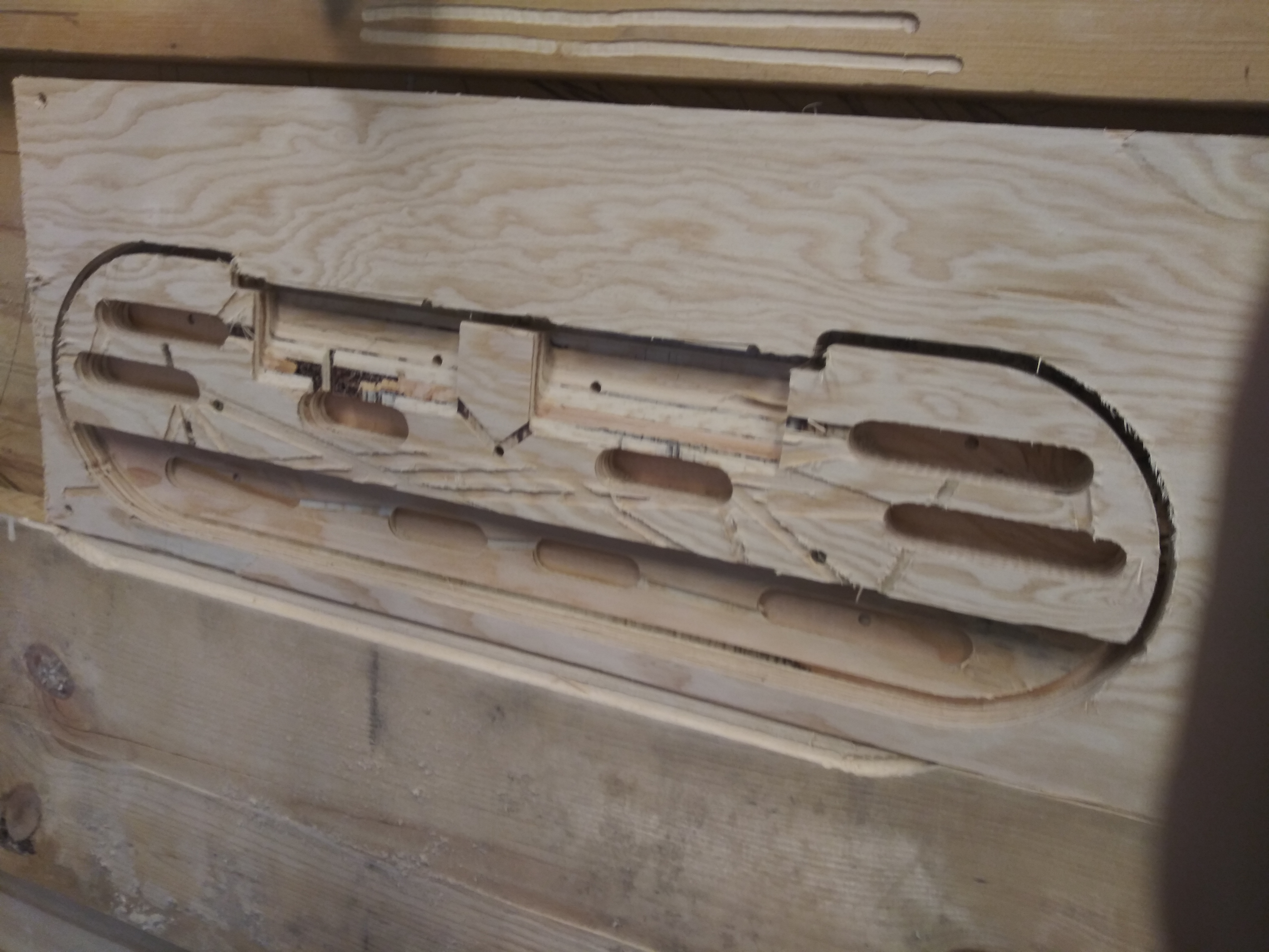

Made hangboard for rock climbing workouts modeled after the BeastMaker. 1/4 inch straight cut. 1.5 inch deep with some slopers on top. Didn’t glue the two pieces of plywood together and now I have two templates to apply to some hardwood!
