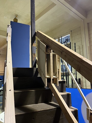

It’s not as visually interesting as many of the projects posted here—it’s part of a mechanism for a stage effect, so it won’t be visible when done—but after eight months of struggle (mostly due to my own missteps and errors), I got clean cuts without issue! I’m pretty excited about that.
When I’ve assembled it (and before it’s all covered up and hidden away), I’ll add a picture of the assembly.

I think that it is a BEAUTIFUL mechanism :grin:
in pizza we crust, that’s almost as good as “don’t get curried away we have more food on the way” (source)
And here’s the assembly installed, with a video of it in operation.

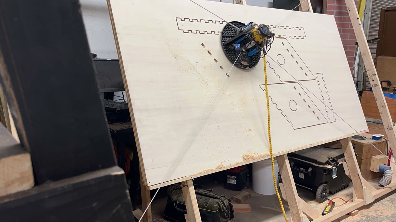

That looks great! It appears you’re oversizing your cuts that the tabs insert into? How much wiggle room are you giving it?
I actually undersized them (set the wrong stock thickness) and had to enlarge them by hand (and very roughly). When I have leisure, I intend to experiment to learn what my allowance needs to be; lately, I’m including an allowance parameter so I can easily modify it.
