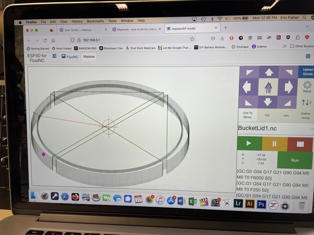

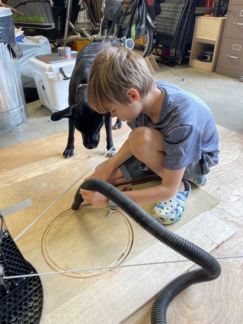

My very first M4 cut was a simple bucket lid. Just a trial after getting the machine setup and calibrated.
(My two helpers)

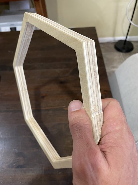

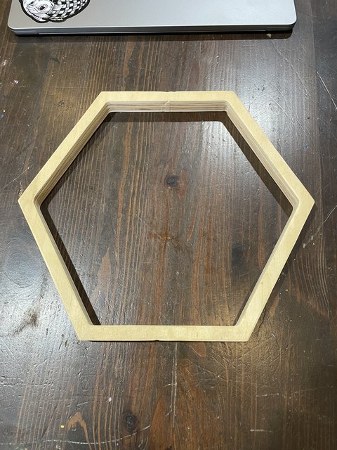

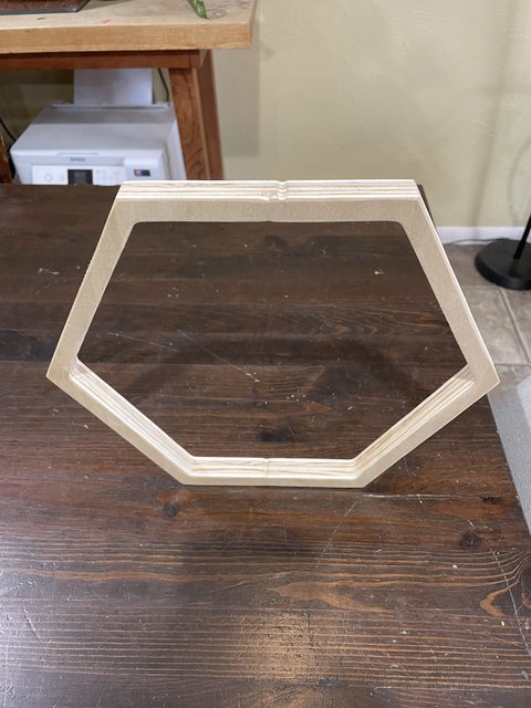

The second cut I made on the M4 was a simple hexagon shape. The bucket lid and hexagon were the first two things I designed using Onshape while learning the software, and first things that I experimented with in Kiri:Moto. My wife and I sometimes say to each other “your’re my bestagon” (inspired by the popular CGP Grey video) so I thought it would be nice to cut her a hexagon.
Overall, I’m impressed how nice the hexagon shape turned out. Only real issue is the little notches the M4 left at the start/end of each cut, which can be seen in the last two photos. I have lots of work to do to dial in the cutting speed, router speed and other settings to see if I can get rid of these artifacts and achieve nice straight lines.

Your helpers look very attentive and dedicated!

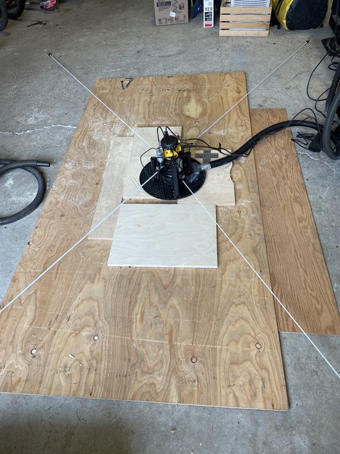

I needed a stool so I could sit while the maslow cut. Used construction grade ply since that’s why I had around.
This looks great! It’s practical and nicely designed!
What CAD software did you use?
