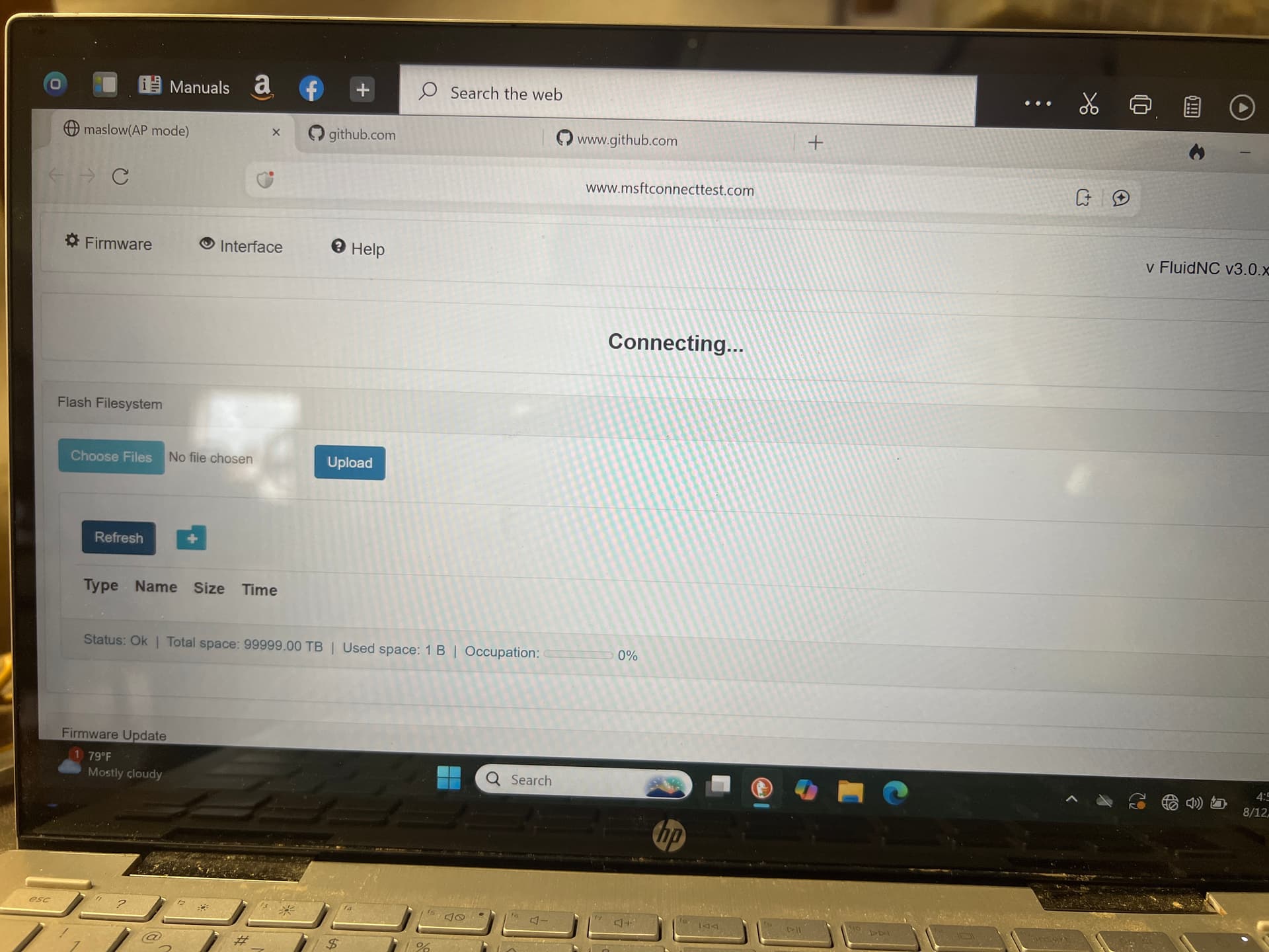

Day 3 of trying to figure this widget out! I turned off my router in the house and was able to connect! This is the page it took me to.
Great google moogly! :man_facepalming:
It looks like somehow the index.html file which sets how the interface looks got deleted. You can use the “chose files” option there to upload it. You should pick the version which matches your firmware version.
You can also upload the latest version via USB cable and that will wipe everything back to factory settings.

Nothing is happening :man_shrugging:t3:
Truly nothing at all? What happens if you refresh the page?

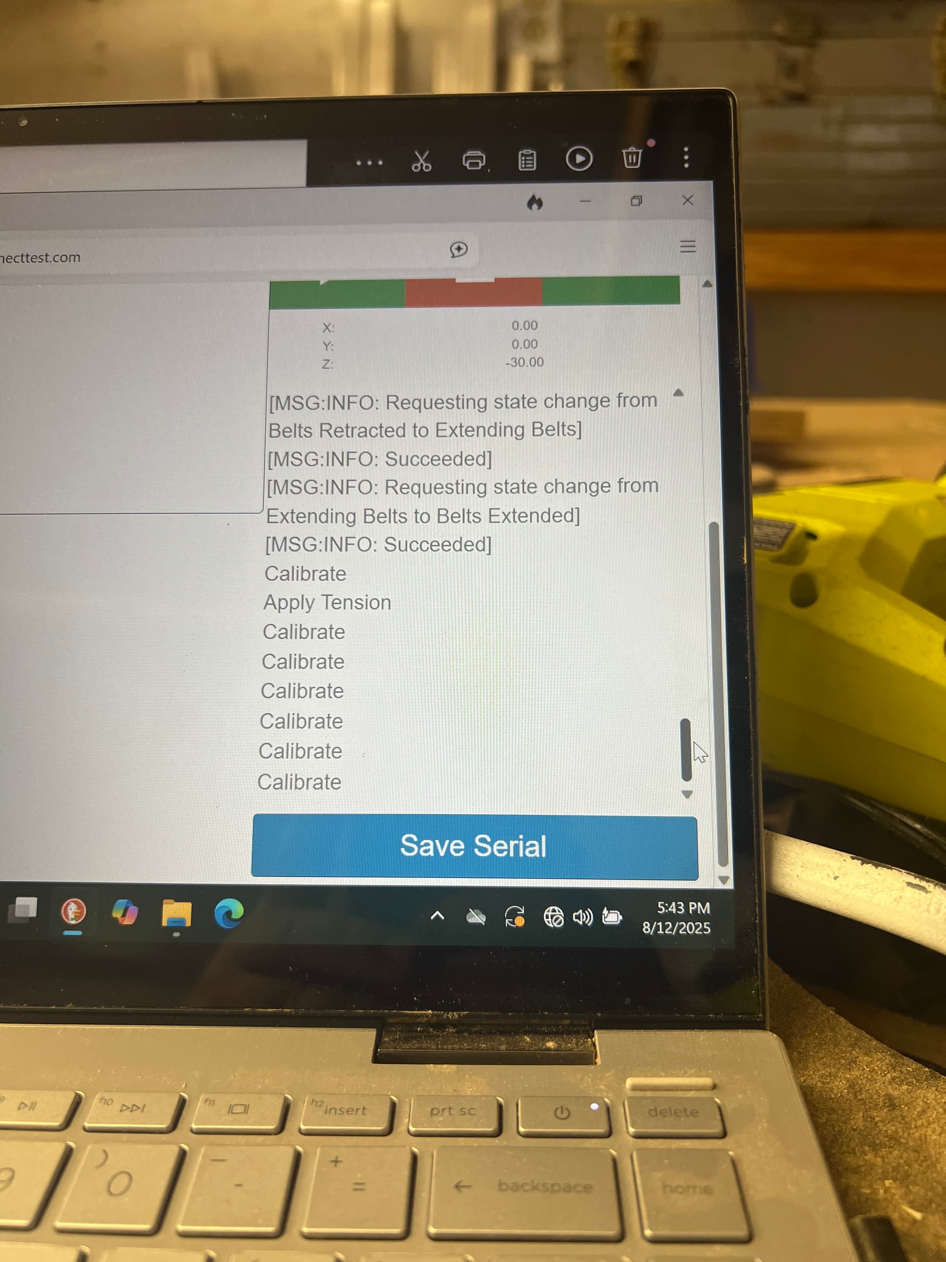

I was experiencing some of these issues, as well. Some things that helped me are:
  1. When my Maslow first gets powered up, it takes about 5-10 minutes to generate it’s own wifi network called “Maslow”. This can seem like nothing is happening or something is wrong, because you won’t see the Maslow in you Network Tab right away. When the network comes up, you have to manually connect to “maslow” and provide the network password (12345678) if you haven’t changed it. After you manually connect, you may lose the connection later. If so, I had to unplug the Maslow and plug it back in to reset it. Then I had to go through the Retract All-Extend All-Apply Tension sequence to get my machine positioning back. You will need to finish calibration to get you machine positioning (X0Y0). My calibration took over 3 hours so you my have to be very patient and don’t run your router during calibration.
  2. Maintaining connection to the machine. Sometimes the connection to Maslow is weak or spotty. Not much you can do in this case except wait until it gets stronger. If you have a good connection there are things you can do inside FireFox to keep the connection to the machine for more that 5 or 10 minutes. It will help if you have a dedicated laptop or notebook used only for your Maslow, because you don’t want to have undo everything after you run you Maslow. Go into your FireFox “Settings” tab and set your homepage as the numerical address of the Maslow. I believe its 192.168.0.1 . Go through all the settings tabs and uncheck all the search engines. Uncheck most of the other boxes as well. You don’t want your browser to get distracted by trying to connect to other networks or ping other websites. Uncheck any report to Microsoft, or Mozilla, or Google. Try to get Firefox to focus only on Maslow and nothing else.
Hopefully this will buy enough time to finish the calibration. Also, I had to set the retraction force in the configuration tab to 1500 to assure all the belts would tighten during configuration and apply tension.
These are just a few suggestions that seemed to help me. I hope they can help you as well!

From experience it won’t ever have a solid connection. I’ve been dealing with this since purchasing the machine 2 months ago. There really isn’t any remedy. The software doesn’t know if the machine is connected or not.
