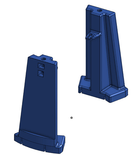

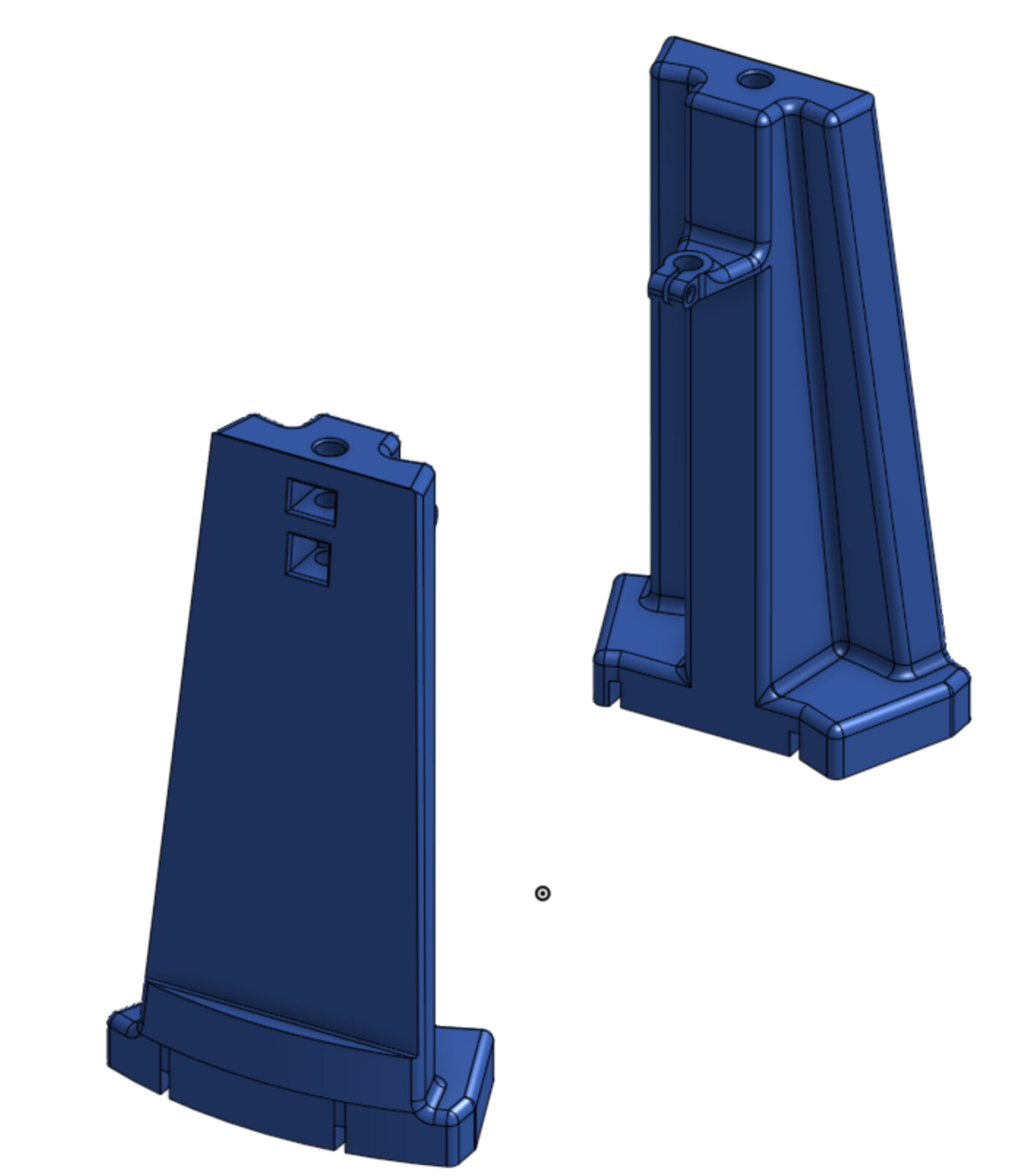

I’m planning to try and print these supports over the next couple of days to give the rods more support (the stock ones are great in terms of resisting movement radial from the bit, but the combination of injection molding draft, thin ears, and a fairly narrow base mean they don’t help much in the circular direction around the bit)
I have these as one piece and two piece options, I’ll be printing the one piece version (the reason these extend above the rod clamps is to give a good way to attach a handle or mount electronics, the flat outside is so that I can mount the power supply to the sled and only have one power cable rather than two)
