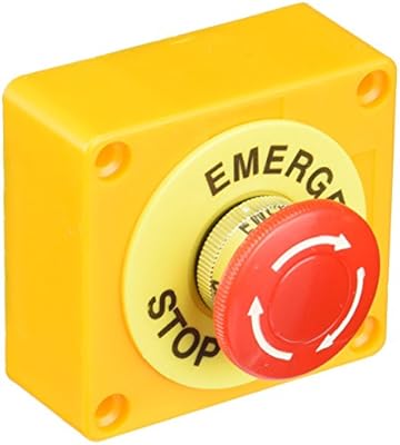

I’ve salvaged a couple of microswitches from an old PC mouse, and have a ‘PANIC’ button all soldered up to some ribbon wire ready to hot glue onto my Z-axis, but don’t want to be so bold until I know how to hook it up at the Maslow/Arduino end. Any hints greatly appreciated ;¬)
Real E-Stop switches are easy to find, below is one already in a box. Much cheaper on eBay and the big rock candy mountain (i.e. Chinese megastores) but without free Prime shipping they take from a week to a month to arrive in Mooseville. Hmm, if I leave all the stuff on the end of the link will the referral fees fund another Maslow?
