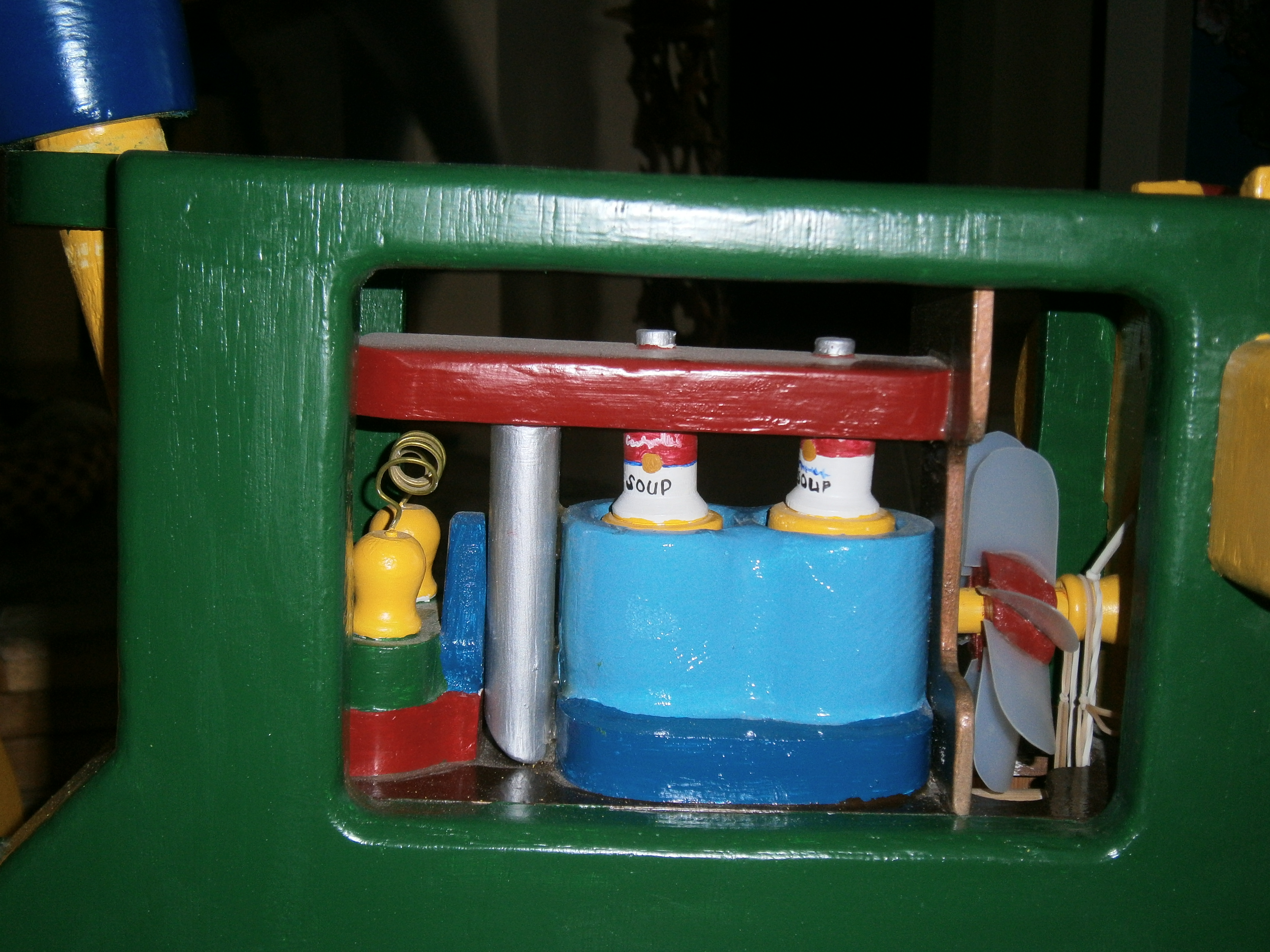

Ride on tractor (engine moves, fan blade turns when crank in front is turned).
The wheels are designed to be taken off by child using wooden wrench.
(The “Cross” in the seat was done “on purpose” - Lived in Dubai (Muslim country) at the time I made this)
Close up of engine (soup can pistons).
