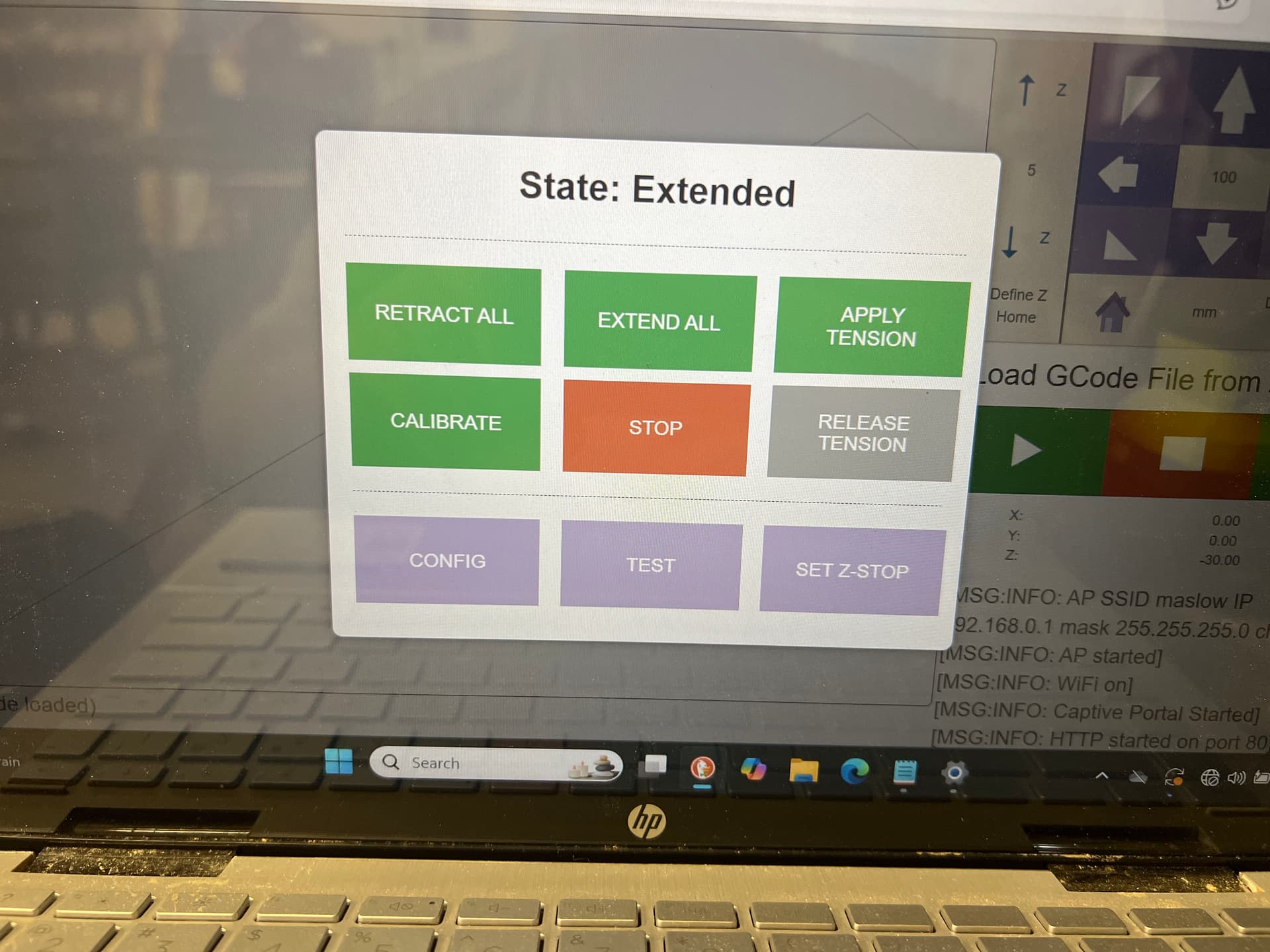

I’m able to get to this screen then nothing happens. I did notice my clamps for the router are both broke. So I need to order another set of them. I’ve tried refreshing the screen and rebooting to no avail. I’m getting really good at the first few steps. I think may delete the files and try downloading again.
what is the URL that you are connecting to?
We have seen lots of cases where the browser/os is trying to have you login to a
network where the browser that it pops up is limited and doesn’t fully work.
