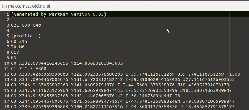

The online version of MakerCam is not recommended for Metric (mm).
It produces up to 16 digits after the decimal and that has lead to problems with ‘buffer-overflows’ in the past, with MaslowCNC and GRBL.
Although this issue was discovers a while back and we assume it has been fixed on our side, my recommendation is not to start with a g-code like that.

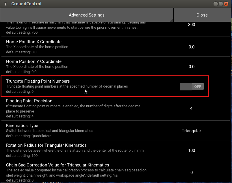

*Edit: Since the offline version crashes on various occasions the recommendation is to use Inch.
If you use metric and notice an interruption in the execution of the cut or other ‘strange things’, you can try if turning truncation on in GroundControl solves the matter.
-> Go to settings, click on Maslow Settings to access the Advanced Settings and turn on -> Truncate Floating Point Numbers (default is off).
