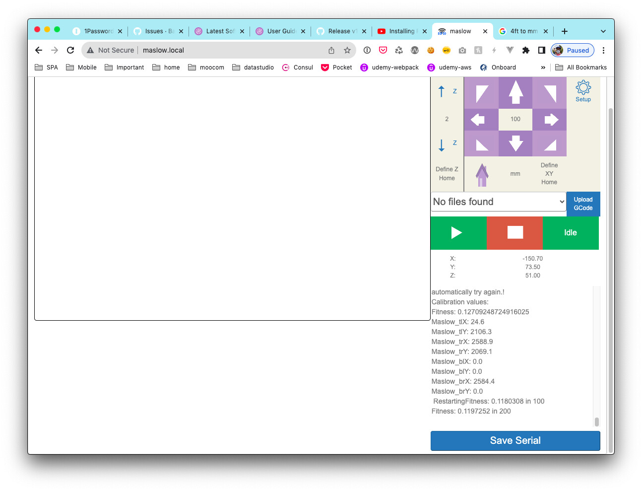

Just updated to 1.0.7 and trying to get things back up and running again. I did a calibration that seemed to start off pretty well but has been ‘crunching numbers’ for the last 5 hours now. Granted my shop laptop is a decade old and probably super slow, but this process has been retrying without any meaningful updates all day.
What are my next steps?
Fitness: 0.1206492 in 1200
Fitness: 0.1206492 in 1300
Calculated Fitness Too Low. The process will automatically try again.!
Calibration values:
Fitness: 0.12064924786715958
Maslow_tlX: 27.9
Maslow_tlY: 2134.6
Maslow_trX: 2606.7
Maslow_trY: 2044.8
Maslow_blX: 0.0
Maslow_blY: 0.0
Maslow_brX: 2564.0
Maslow_brY: 0.0
 Restarting

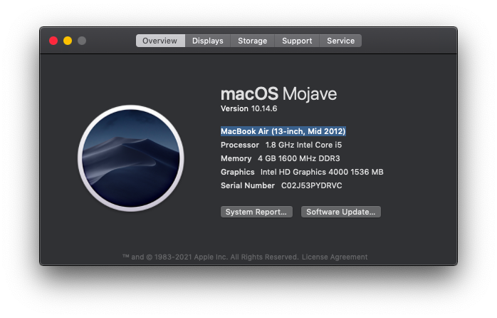

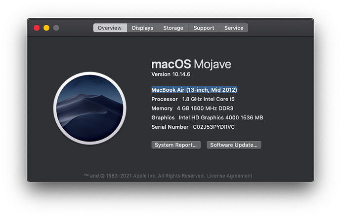

I’m having significantly better luck today. I don’t know much about the calibration process other than I believe one of the videos says it runs on the client machine instead of the maslow because or resource allocation. Running from my desktop is yielding positive results. My garage laptop must be under powered.
Garage Laptop:
