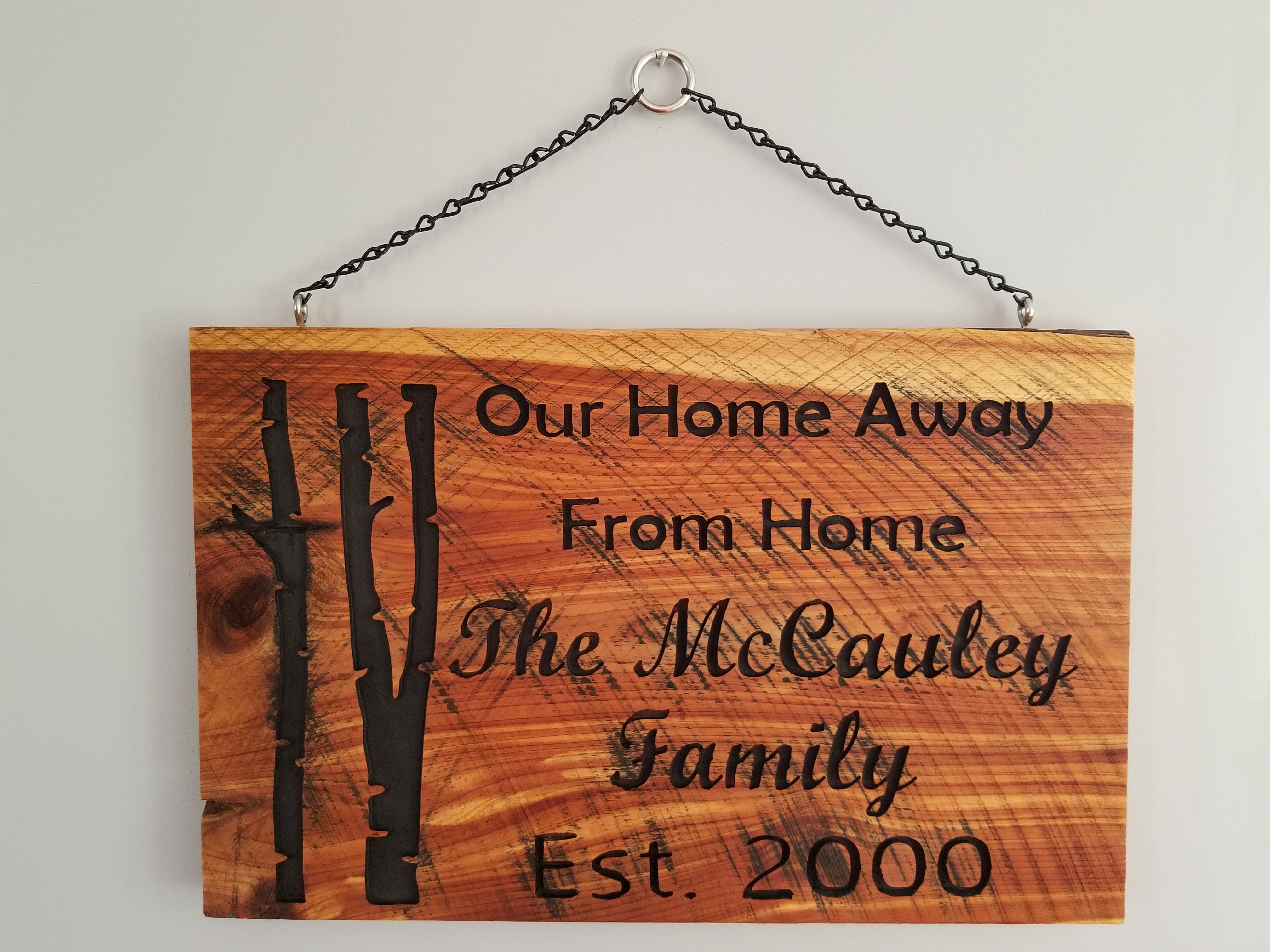

My parents are avid campers and with mothers day around the corner i made this camper sign. When camping people hang these at the end of there sites to introduce themselves to other campers. Designed and G code using easel. The logic of there G-code doesn’t seem to make sense- it will finish a letter then go down to another word and back and forth. IE T then G etc. Used some shipping create plywood that i got off craigslist. Sign is around 20x20. 90 degree bit, full speed, about .05 per pass.

Use a 1/16 bit to curve out the pockets for each letter. Wood is some rough cut cedar. Spray painted the front face, sanded down and oiled it up.
I had the same issue as Ttitobob where the cut seems to go from random letters.
