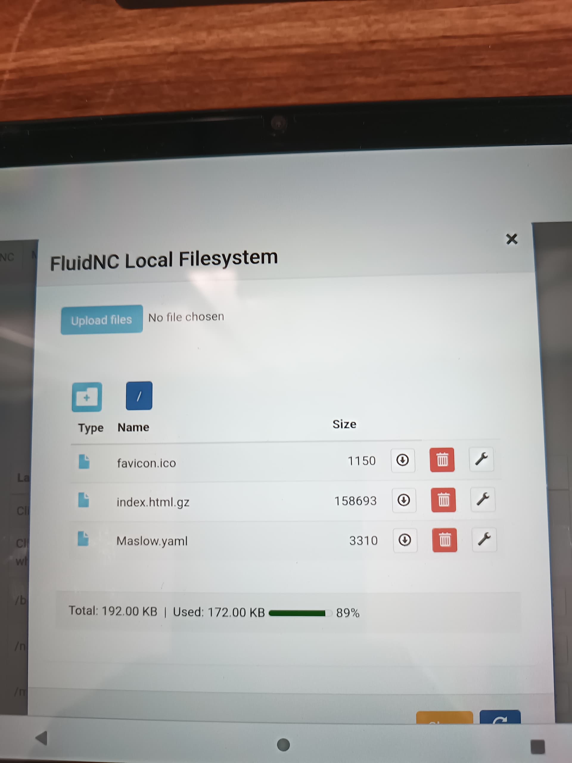

Do I need to delete all 3, restart it, upload all 3 and restart again?
that sounds like a good idea, it’ll need to be maslow.yaml not Maslow.yaml

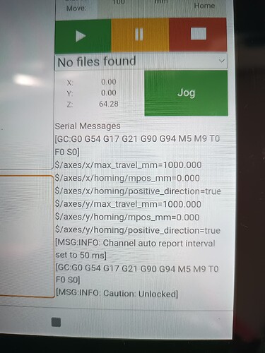

Here is where my fluidnc section looks like.
Yes, I think that the capital M is probably the issue. The file name needs to be the same or it won’t be able to find it.
Guess I will have to switch computers or something… The upper case is not there in the download. I can’t find the firmware and all that on GitHub. All I find is old stuff. I had values saved in the new firmware but now they have been changed. Where in the forums can you find links to update stuff. Guess I need to find all 3 and start from scratch I guess. So lost here. Any chance of a new video door the most current stuff, numerical values and what not. I know your probably going crazy with all of us right about now. Lol

@bar OMG…you were right, step away from the machine and breathe. I had to work the last couple days come home early today and upload all new files and bam! The belts retract and the Z axis moves. Now let’s see about calibration!
