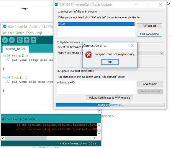

I want to thank you for your support yesterday. I have set the board and the port correctly. I am updating the firmware following instructions and below is the error message I receive.
This is not that hard and don’t understand why this is not working properly.

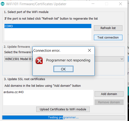

Also when I run a connection test this is what I see. I noticed on yours you have a programmer and I don’t show this on mine, am I missing something?
First it looks like you try to upload the firmware from inside the zip file. You need to unzip it to a folder and upload from there. You should have all this tabs at the top and not one.
The WiFi confuses me totally…???
I think I see part of the problem - I’m using the Tools/Board menu, not the ‘WiFi101 Firmware’ one. We don’t have a Wi-Fi connection to the Maslow board, we use a USB Port instead.
As to the ‘Error compiling’, more information from that error would be helpful, but one common problem is when the files of the firmware aren’t kept together. The firmware download contains a folder ‘cnc_ctrl_v1’ with all the pieces needed and in their proper relative places. Navigate into that folder and open ‘cnc_ctrl_v1.ino’ from there and Arduino will find everything it needs.
@Gero is right about unzipping the file, that’s probably the issue for you.

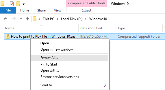

I have not used a win$ for 11 years now, but this does not look unziped.
Isn’t it just showing the content of the zip file?
Click on the file with the zipper and check your options for unzip.
Edit: Perhaps a ‘right click’ and ‘Extract All’ or does this ‘Compressed Folder Tools’ show up?
