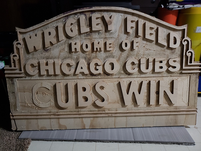

Cubs and Hawks Sign
Haha oops
I held router and sled and routed the M,E and G’s by hand. Lol but as i was cutting perimeter it jumped the corner and messed it up again! :worried::worried:
Maybe i can fix with wood filler. Not sure. It’s been a difficult journey trying to make that. Lol also routed the C as you suggested. Great idea by the way. :thinking: but it is what it is. Not bad for my third item. The Iowa State sign came out great, that was my second item and sled was first. I do really appreciate all your help and the files. I may try cutting another with the other file you sent. I never set it up for a toll change, so that’s what i don’t understand. Lol I ordered a 30 pack of assorted bits that should be here tomorrow with another CNC i ordered called an X-Carve. It’s a 4Ɨ4 table 3d router CNC. Maybe try the Cubs sign on that for first cut. Or maybe I’m trying something to big and advanced for being new to CNC. But i think i did ok for first try at it and figured it out with no knowledge whatsoever of any of this. Learned a lot in a couple days really.
