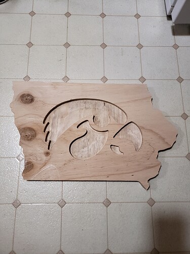

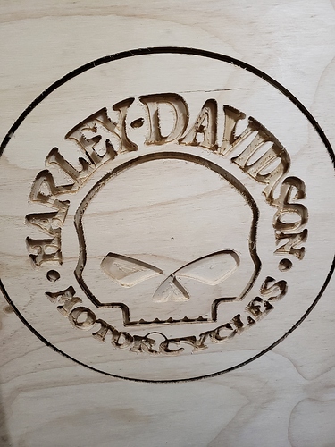

@blurfl it just takes forever to complete, because it runs so slow when doing it.
It’s there to use if it makes your Maslow work better! That circle mis-cut is puzzling. A garbled gcode for an arc could do that. I wonder if there might be electrical noise on the USB cable? The router power cord, or a dust collector cord close to the USB cable can cause communication trouble.
It could be. I have vac and router plugged into a different power strip than laptop and andrino. I do have andrino and USB wire tied together and running to laptop and then two power plugs going to separate power strip. It did it at the end of the run. I thought, yes it finally cut proper, then bam it did that after it was complete. Heart breaking when you cut something and then it does that. It also froze after it asked me for tool change. Had to clear Gcode and restart GC and play with it to find out where to define center to start it again. It wouldn’t do anything, not even let me define home on Z axis.I guess I’ll start writing down start position. I kept adjusting sled and then running gcode with router off till I found the path again. Took a bit, but I got it.
Unfortunately that semi circle miss cut is exactly the kind of thing we were seeing sometimes when we had the buffering of lines on automatically :frowning_face:
@bar, but it wasn’t on when this happened. I’ve cut five things now and every one of them have had some sort of issue but one of them. Getting very frustrating. :confused: the Iowa State sign is the only one that’s cut with no issues.
Darn, well it looks very much like a communication issue to me. Some of the instructions to the machine are arriving garbled. The first thing I would recommend trying is a different USB cord, especially a shorter one. The work shop is a very electrically noisy environment and so the long cable can pick up interference
A shorter cable fixed a lot of the problems I had when first setting up.
@bar @ScrumdyBum I’ll give it a try guys!!
