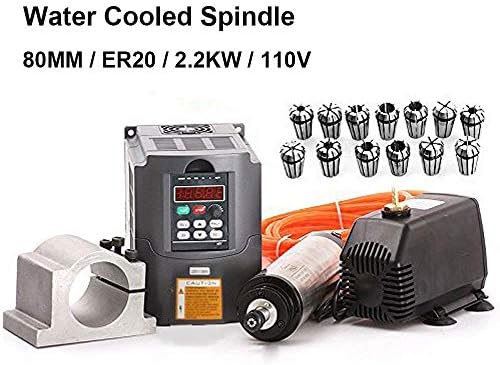

Sure:
I chose this one since it is both the largest spindle that still uses 110 volts and the smallest spindle that will take half inch bits. That and the fact that if the Maslow didnā€™t work out I could reuse it on a DIY CNCā€¦
We should start our own thread as founding members of the ā€œMaslow Spindle Clubā€ :joy:
Haha, it looked like a big spindle. That will clearly have all the power you could need and then some. Nice!!! Canā€™t wait to see it in action.
FWW - You might want to run the water lines attached to the lines going to the dust collector and incorporate the pump at the collector.
