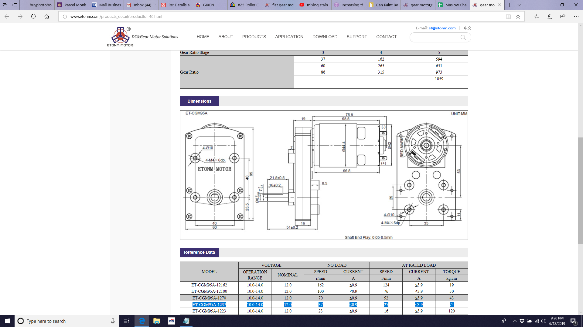

if no one has tried bigger sprockets has any one tried faster motors?
http://www.etonm.com/products_detail/productId=46.html
would this motor work? it has 74kgcm torque vs 50kgcm torque of stock motors and a faster speed of 27rpm vs 20rpm. 35% increase in speed sounds reasonable. I dont’ ever expect this machine to be 250% faster than it was initially but I do think there is modest room for improvements.

that looks like it would be an improvement (although note that it draws 4A, the
stock motor shields support 2A and the smoke herder shields support 3A), but it
does not have an encoder, so you would need to add one.

etonm makes an encoder for this higher power gear motor
http://www.etonm.com/products_detail/productId=95.html.
Making a 24v motor controller shield is beyond my knowledge unfortunately. I wonder if the TLE5206 would need to use thicker copper traces to support the 3.9a per motor, total of 8a, that is a decent amount of current at full load, though I do not know if the maslow would put it into full load very often.
ET-MY42-dc gear motor manufacturer/Etonm Motor Co., Limited.

I have looked through etomn’s website and do not see a more powerfull 24V motor. Is there a specific one you suggest? Actually I was surprised to find the one mentioned a few posts back, because I have looked for more powerful motors on the website before without any luck.
I think I will try the 27rpm 4a 74kgcm motor first and if it works, then I can push my luck with bigger sprockets and if that works, I might try 24V motors.
I will email them for costs. I doubt they will sell them individually, but might sell a test batch.
That page you linked to for the motor says it supports up to 24v.

they quoted me about $220 for six sample motors with shipping included ($80) Not sure why they can’t ship them eparcel/packet for $2 like every other Chinese seller does, lol. . However I am skeptical about getting them since it appears they do not use a worm gear and thus the gears might slip when the power is turned off is my understanding?

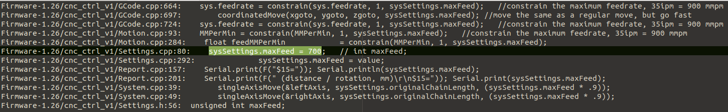

Going back to the first post, @MeticulousMaynard was on FW 0.94 or 0.95 on that date is a guess.
A lot has changed since then.
Strongly trusting Davids numbers that X/Y motors can do ~ 48 inch/min ~ 1219.2 mm/min.
With a TLE shield and equalized power supply it was not tested yet (to my knowledge) to edit the Settings.cpp line 80 (FW v 1.26) before uploading the FW and changing the feed-rate in GC as well.
@aluminumwelder, do you have a TLE? Just thought it would be worth a test going near 1200mm/min before spending money. Other then the to high number of “Sled not keeping up” reports, i would also expect that missing acceleration/deceleration could start kicking in. Sadly not ported back from the Due branch (perhaps the Mega limits).
Programmers:
A grep on ‘maxFeed’ is sending mixed signals (700 vs. 900), only in the comments i guess.
