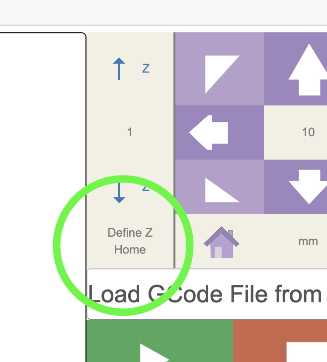

Z Home set here should be the top surface of the wood (that’s the one set by probing).

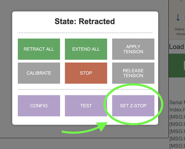

Z Stop should be the z-axis all the way down to the lower limit so that it touches the stepper motors set here:

Basically just run the Z axis until it stops on the motors then. Will that be lower than with the collet barely touching the wood(As it is when calibrating)?

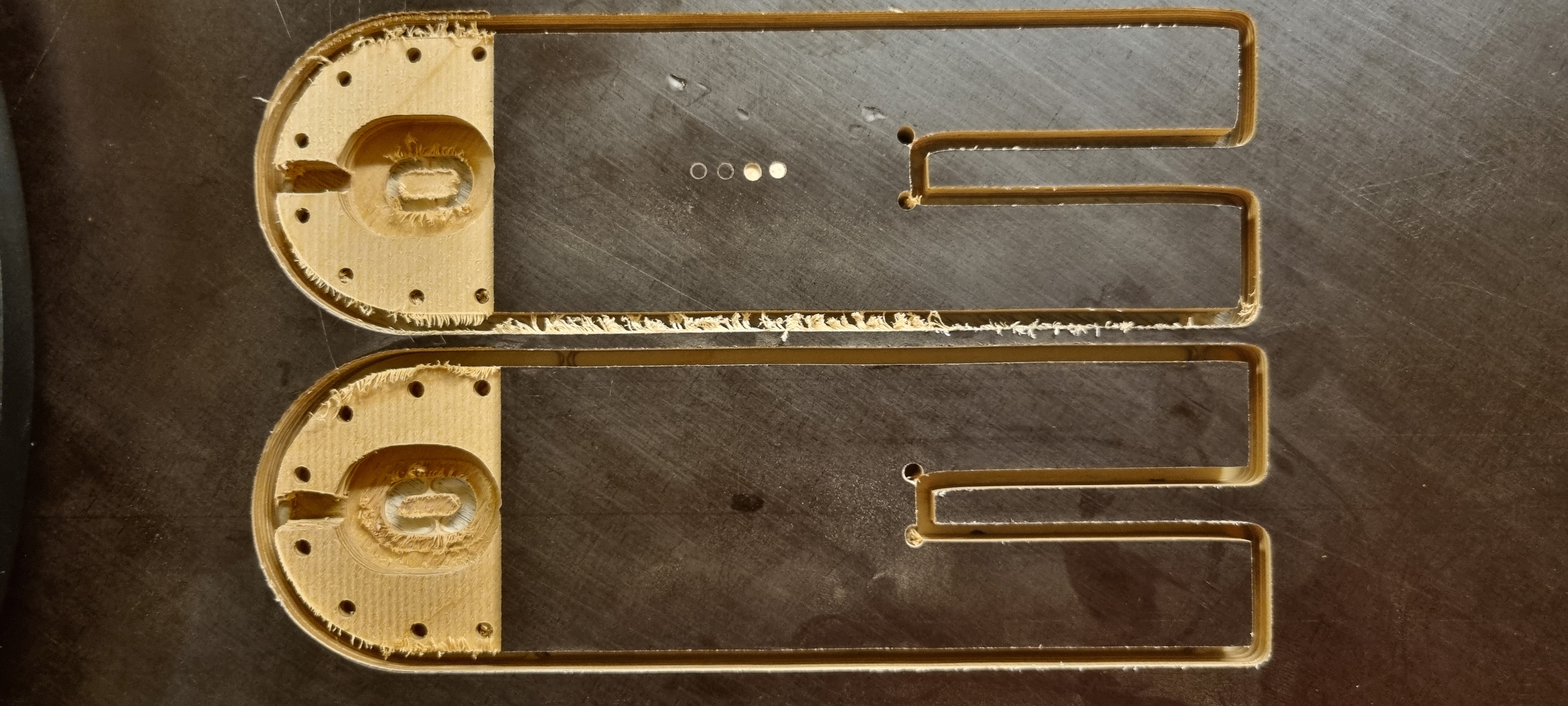

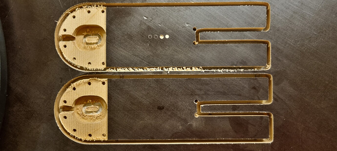

Top part was cut with the old firmware and Z offset settings. We adjusted the Z offsets correctly and calibrated before upgrading. Transferring the values went fine, but we will test calibrating with the new firmware tomorrow. Should we go through more grids, as in 3, 5 then 9, when calibrating to get a better result?

I wouldn’t expect these changes to make a difference for accuracy :confused: These changes are more focused on generally improving and updating the underlying systems to handle the math in a more correct way but at this point everything should be working almost identically to before…just under the hood everything is done the right way

Calibration went without issues all the way from 3x3 to 9x9 after restarting each time. Fitness score went from 0.67 to 0.88, but the results of the cut afterwards was really bad compared to the last time. The whole machine seemed to be a little “loose” compared to the last runs. It seemed to be tipping easier when changing direction.
