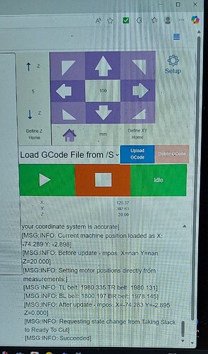

Updated the machine to the latest here maybe by the grace of god it would work but as expected it does not work, yet again.
I loaded V1.09.
It does not like a zero value in the Z positions, (I.e. TRZ etc) Error can’t find XY location, so changed that to 10.
Pausing and then restarting worked. It would be nice to be able to cancel a job part way through.
When I paused a job, machine just ignored whatever I did from then on, until I did a power reset. (Except for Run).
After restarting and doing the Retract Extend dance it seemed to have lost position and headed for the hills. Killed power and am giving it rest for a while.
The position was not related to actual position as worked out by the Retract Extend. I had set the home position to bottom left, moved off it by x=126, y=302 & z=-20. On resuming it had set the position to x= -74.283 & Y= -2.895. When I tried to re-run the test print again it started heading off diagonally Up and Right. Previously (earlier versions) when I reloaded after a failed attempt and started it again, Z required resetting but it would start the action relative to the previously defined (XY) Home position. This wasn’t a failure I interrupted the run.

Great feedback! I’ll look into that and see what is going on there. I did add settings for spoil board thickness and material thickness which interact with those z-values so maybe there is a divide by zero or something happening there. Great catch!
I agree! I think that pressing stop in the pause state should end the job but restore control. The way FluidNC handles everything internally is a bit chaotic so that might take me a little bit to get added because I need to sit down and really understand what exactly needs to happen to end a job without leaving something messed up.
This is super interesting. No idea what is going on there, but I will try to replicate it.
I confirmed that this was a bug and it will be fixed in the next release. Thank you for catching that! :heart:
