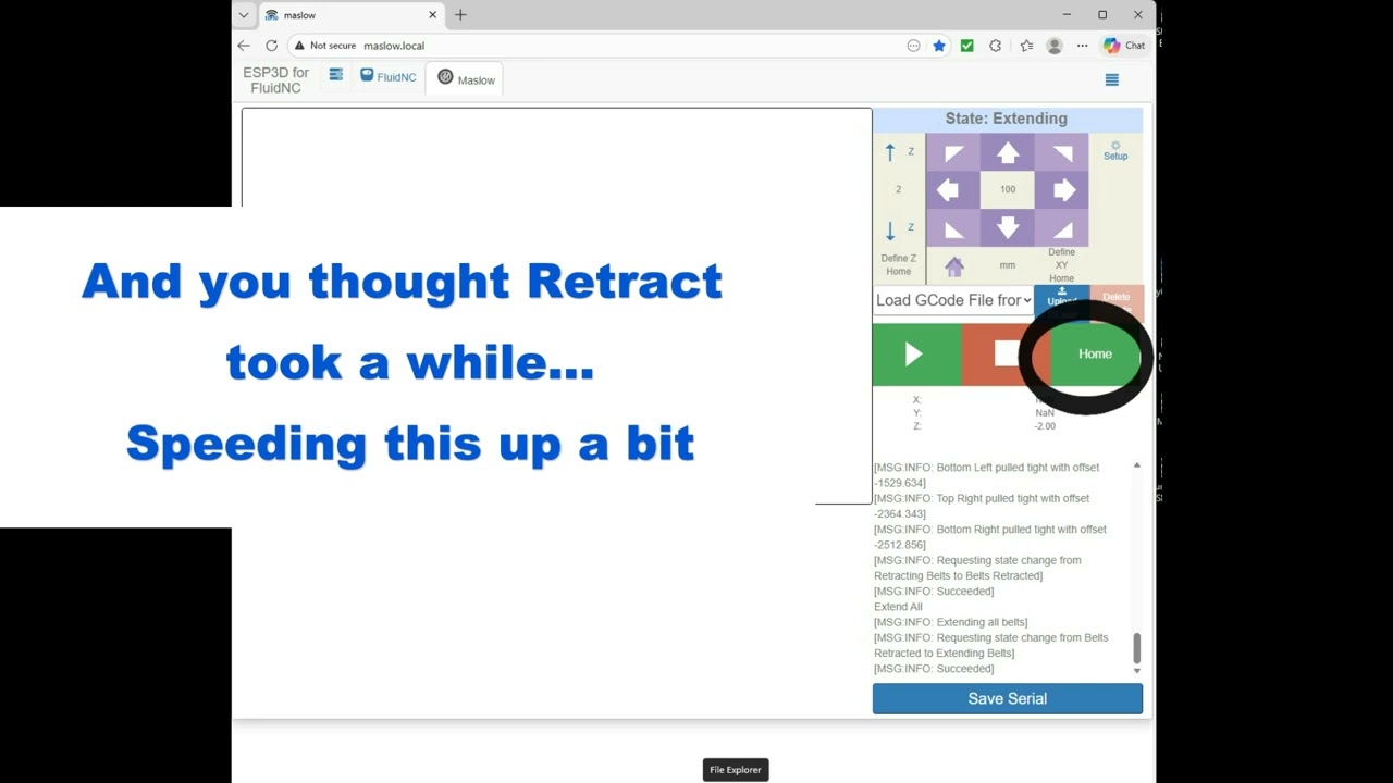

Video to show sequence from Unknown to Ready to Cut

I think that this is a genius idea, but I think we should move the button up below “Setup” having it share the same space as the FluidNC status indicator seems confusing to me. Like sometimes that button says “Retract” and clicking it will cause the belts to retract (which makes sense), but then sometimes it say “Home” but clicking it then won’t set the home position.
